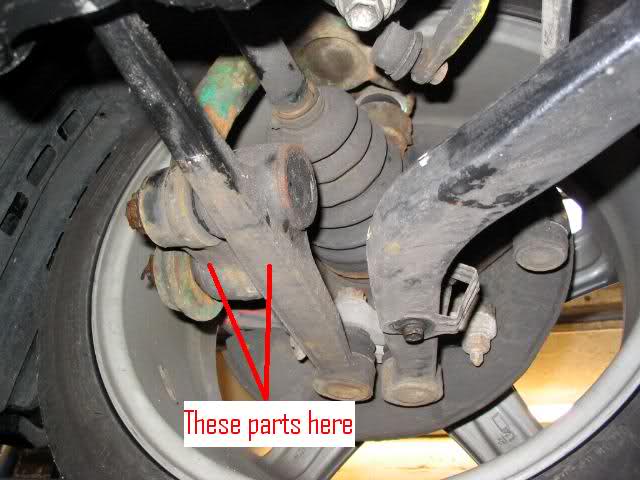

recently my superstrut noisy for the 2nd time.
now both side noisy, it last only around 30k km or less.
Any mechanic that can diagnose properly rather than just replace figure 8 and control arm? in fact i dont see anything wrong with the old figure 8 and the control arm that taken out last time too.

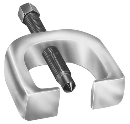

u should buy either 1 of this tool.. it's to open ur superstrut..
usually mechanics doesn't have this special tools.. they'll use hammer to open it.. so, u need to buy it urself..

From my experienced, I need to use both of these tools.
this one to remove upper joint
and this one to remove lower joint
but from the half cut, mechanic also knock or hammer out the figure 8 and the control arm out.
unless buying new, the figure 8 and control arm is come separately.
