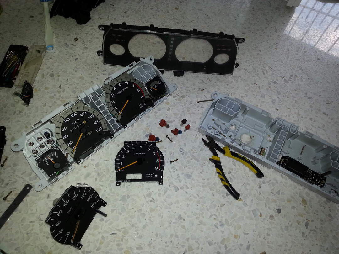

bro can post a full picture and clearer picture of the rear meter? i cant see any burnt marks, on the circuit board you can follow the lines there will be like codes to indicate the wiring terminal/pin...you can see if that burnt area is related to the speedo circuit.
have you checked the speedo cable (if applicable) common the speedo cable tip might be snapped. the part where it fits into the speedo meter
not sure if yours is circuit related or not, but commonly its either the speedo itsself or the speedo cable.
this is how mine looked like (not a corona)
the 1st pic is showing the whole speedo meter removed. 2nd pic is the rear of the speedo. thats where the speedo cable
3rd pic is showing dried solder joints, sometimes cleaning this with contact/circuit cleaner will help
