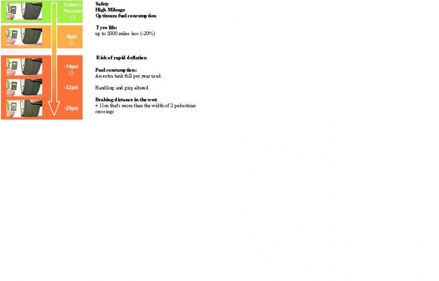

The correct pressure has been established jointly between the vehcile and the tyre manufacturer. Your vehicle manufacturer may place a sticker adivising you of the correct pressures, on the door jamb, the fuel filler cap, in the manual, glove box etc.
