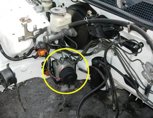

drewn, 750 for the EK disc with abs is a bit expensive. normally it will cost around 450-550.
for the rear disc make sure u send it to any foremen to verify wether it comes with abs or not.
EJ normally comes with 2 type of ABS one is the real one another one is simple ABS (called ABS stopper)...
if u using the ABS stopper then no point to get the rear disc with ABS..
the real ABS got its own so-called ABS controller n its reside on ur engine bay.
That's a bloody clean engine bay!! Woot! Props to the owner yo!.

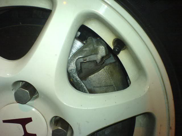

Retaining the master pump means you need to press a lot deeper for the brakes to bite. The proportioning valve is something like brake bias controller, except it's non adjustable.
CTR discs are bigger than EG/EK, and I'm using it.
Here's a photo of CTR rims and discs. (My current wheels, MF-10 got bent lip, under repair)
EK9 CTR rims are 15 inches (definitely), so you can guess how much bigger the discs are based on the clearance of the caliper. I'm guessing 12-13 inches?
