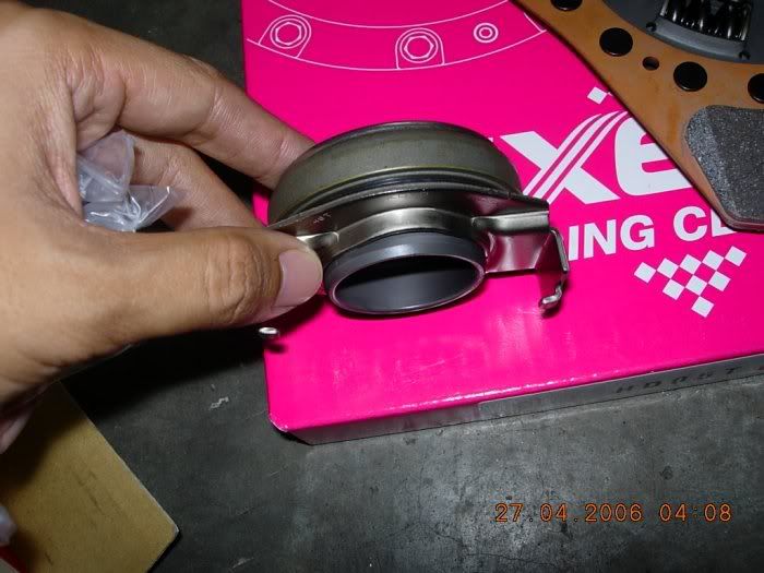

u all talking about clutch bearing like this aa?
hattech-v said:that mean os parts very difficult to get here?
c00lric said:Hi J101,
so that's da symptom of sign that da release bearing needs 2 b changed? What about hard 2 engage reverse gear? Does that hav 2 da wif da release bearing?
J101 said:when it comes to reverse gear, it could be a worn reverse synchro, or a bad gear oil or also could be your linkage.
Which are the 1s that you hav mention ere that dont need to take out da whole gearbox to check?

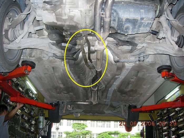

wahh...no use center bullet ka?no wonder ur car so power...muahahaha....hattech-v said:here the gear linkage..
