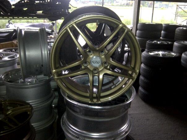

How is the condition of the tyres? Someone offered me this rim at 1.2K, its a 17" 7.5J, I dont know whats the offset. But yes, I am interested in the Evo rim.

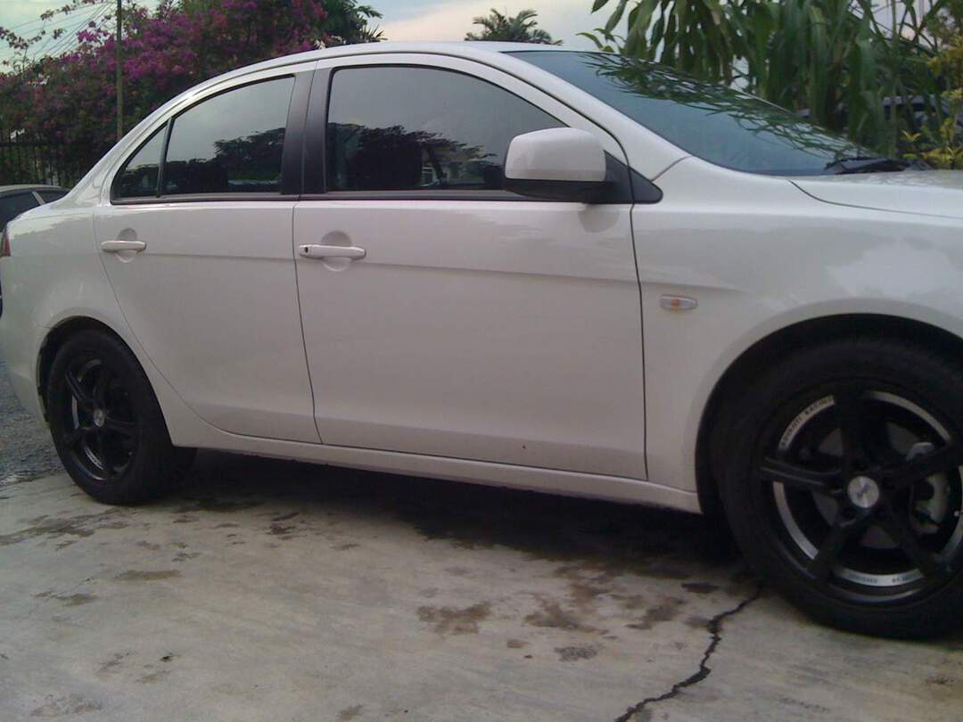

Just fitted with Eibach's Pro-Kit springs. IMO, feels more comfortable than the stock springs. Doesn't look lowered much. Good for everyday use.
Looks good Sylver! How is the ride? You mentioned it is even more comfortable than stock springs, but has the floating feeling at high speeds gone? Yesterday on way from Seremban back to USJ, I was on full throttle all the way 200 - 210 kmh. Definitely floaty at this speeds.
Yea, the comfort is really good. that is also my requirement. went over bumps with ease. traveling at 160kmh (ssshhhhh...) on LDP and didn't feel any floating. need to try it at 200kmh. Haha...
