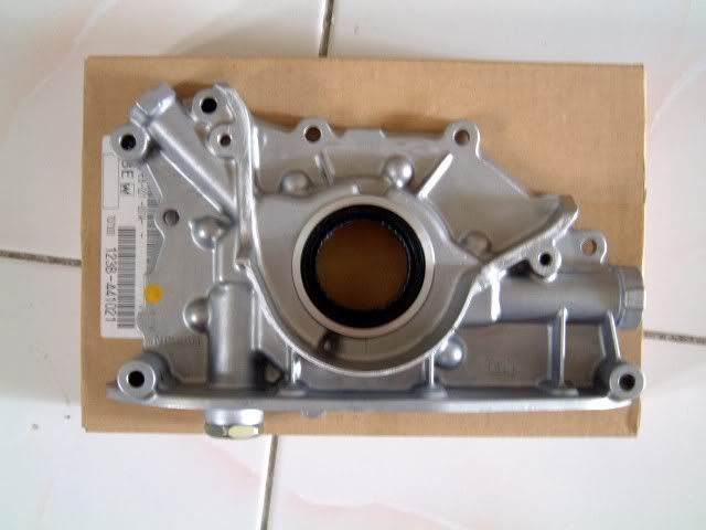

I`m have ready stock at Malaysia for :
N1 Oil pump
N1 Water pump
NISMO thermostat
TOMEI Headgasket RB/SR
Brake Caliper overhaul kit
For belting there is 2nd brand available at Malaysia widely, eg: BANDO as long u knw the belting type. Tensioner/pulley comes 1 set wth original timing belt.
reference:
ECR33: (Fan belt,Power Steering,A/C)
4PK850, 3PK845, 4PK910
ER34:
4PK890, 4PK865, 4PK910
GTR34:
4PK875, 4PK969, 4PK910
Nissan ECR33 Oil Crankshaft Seal:
Front: 13510-10Y10
Rear: 12279-5L310
If u buying NEW oil pump, the front crankshaft seal is INCLUDED.
