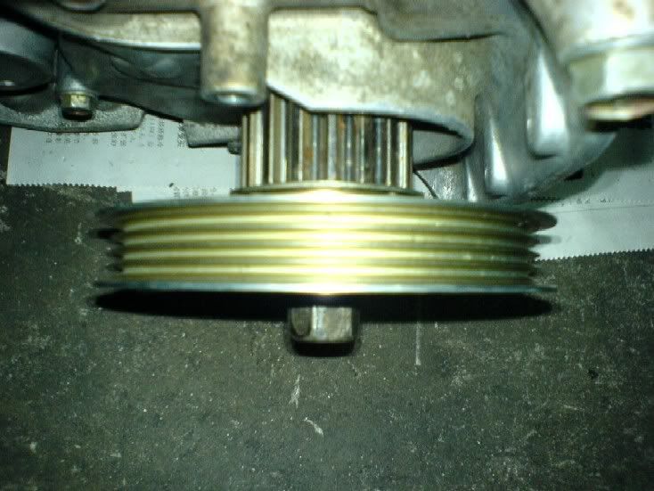

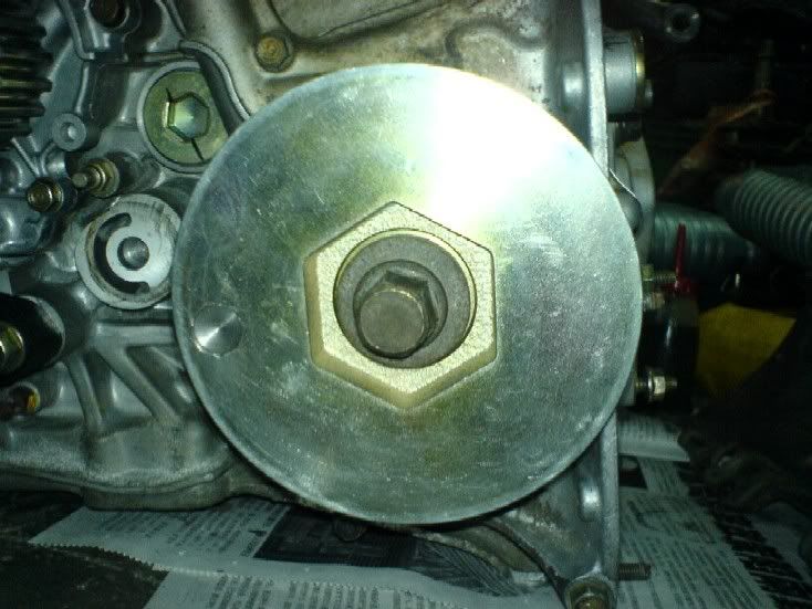

I only used the OEM Honda CTR N1 pulley on my last year MME.
The only reason why i used it is because its OEM Honda, timing mark (so still can check my timing) and lighter than stock. But had been advised by my US friends, that it is not so good for engine longevity, cause there is no dampening at all to reduce crank walk in high rev.
How true, I don't know? Any performance gain, I also don't know cause engine was build with it already and never done a before and after.

CTR pulleys:-
http://i80.photobucket.com/albums/j178/thtan777/CTRN1pulley.jpg
http://i80.photobucket.com/albums/j178/thtan777/CTRN1pulley2.jpg

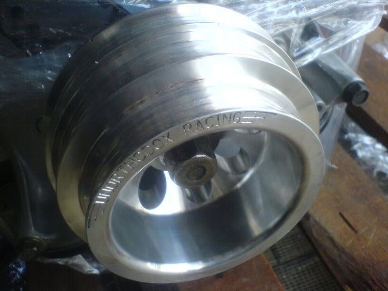

No, not mine, this one is a B18C... customer's one. Still unfinished as yet.
Currently my car still under weight reduction programme.. DIY, and done bit by bit.. so slowly lah. Using a wire mesh attachment on a drill helps make it a wee bit faster in removing those bits left, although it does remove a bit of metal as well.. rust spots abound, as expected from a 14 year old car. So busy settling those ATM. :P
So far reached the 3.5kg mark, and that's just the boot area alone.. the undercarriage.. well.. that one is a bit of a problem, and still KIV'ed. In terms of noise, yeah.. there's quite a bit more sound after the removal of the soundproofing.. but of note is the fact that the SGDM EG SR4 models come without the soundproofing in the boot area and the centre console/gearshifter area.. just had the opportunity to see one without the interior.
