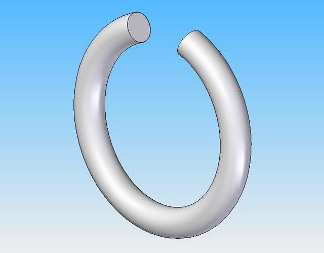

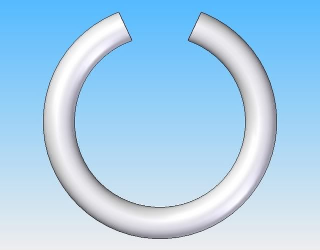

Ok. This is the angel ring shape that i think all of us doing...
While this one is the 5 series punya. Assuming that the ring below is a ROUND rod la... hahaha
Hmm... not that perfect la... The bending after the ring not that correct.

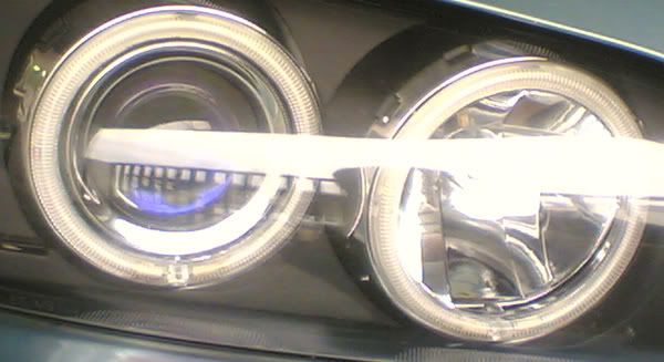

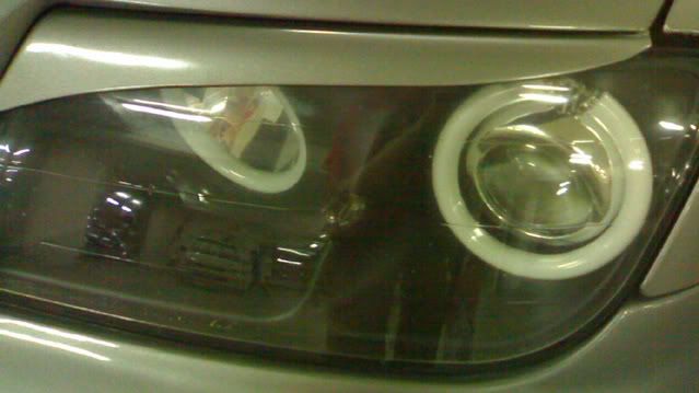

See how he put the ring on..... hehehe..... Don't shoot me ah owner, i just wanna share ah.... haha
The RM900 plus angel eyes...

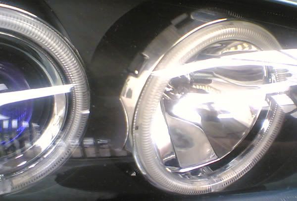

See something inside the angel ring??? Neon rod i guess... The light output very even lo like that...
Look on the upper left
See what's down there... Im noob la...

the 1st pic ... look a bit fail
low bean 1 too big ... n the ring too big also =.=
eh ? no2 no3 no4 .. pic .. waja headlamp ?
shop got sell ?
coz ... not look like make it sendiri
if rm900++ .. can die lor too expensive to me =/

Ngek ngek ngek..... No la! aiyo... that 2nd till 4th is Wira punya headlamp. Ya la. RM900 plus la... never mine la, we all can do our own angel eyes... hehe. Can make it other colour also ma...

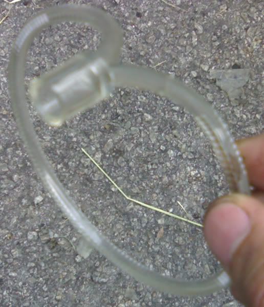

And the best news i got today.... hehehe... i finally got the live/actual image of the 5 series angel ring..... hehe... sure shock you...
Edward Chew
Jun 29, 2006
1,324
136
5,163
www.facebook.com

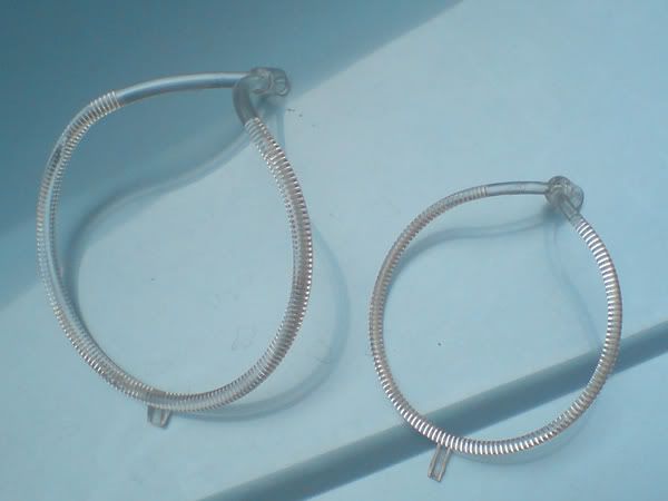

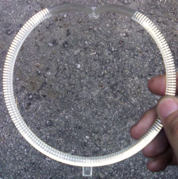

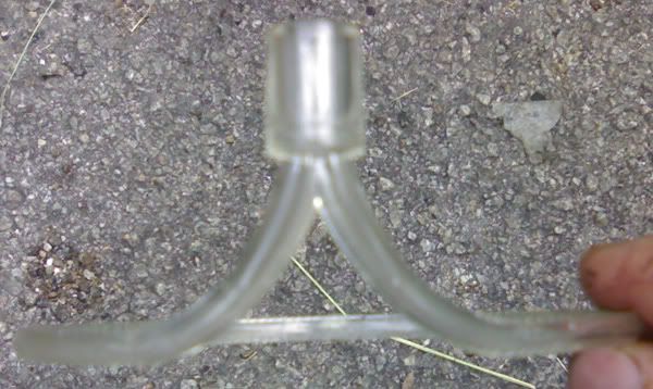

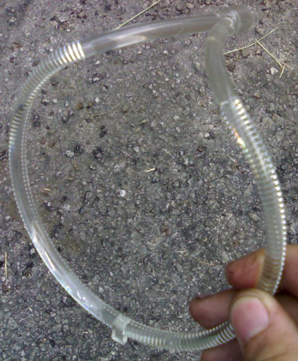

Hehehe... Give you see gao gao the 5 series angel ring...
This is the bending/shape i describe above... quite close huh??? haha

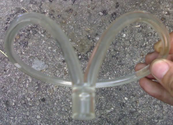

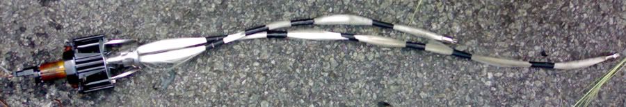

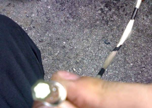

You know what is this??? Fiber glass... used to conduct the light from the bulb to the angel ring. Don't simply touch oh. Painful oh cucuk on the hand.

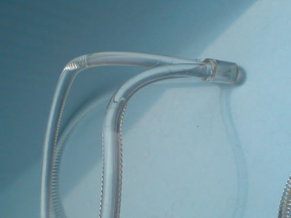

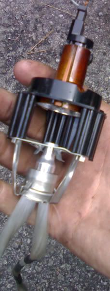

This is where the bulb located.

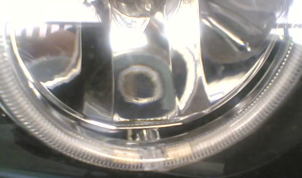

See, if the bulb is on, the light will be conducted by the fiber glass to this thing (on the bottom left).

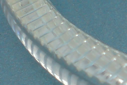

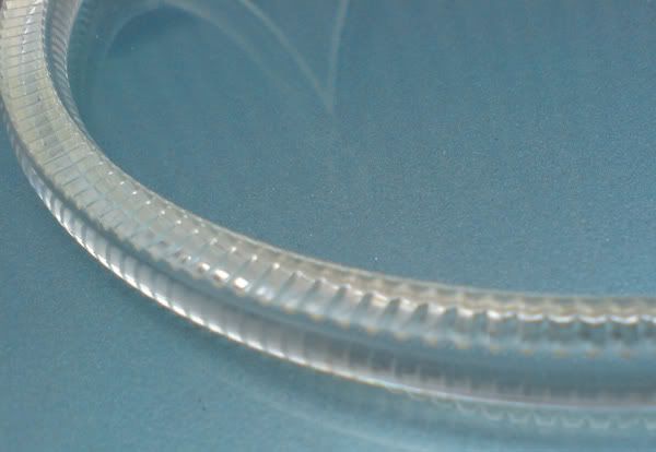

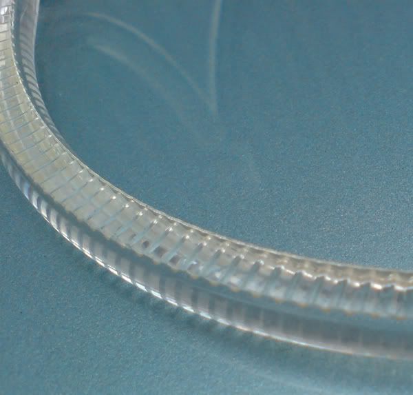

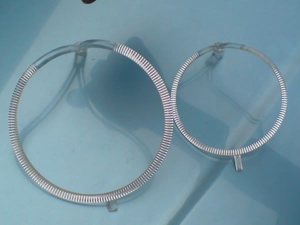

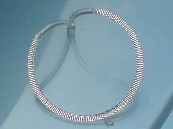

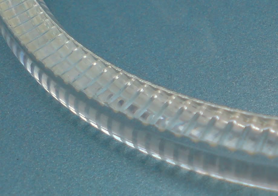

The cutting
Close up on the cutting. See till you understand the cutting/pattern... hehe
Puas??? :baring_teeth: :baring_teeth: :baring_teeth: Give me some credit la then.... hehehe
