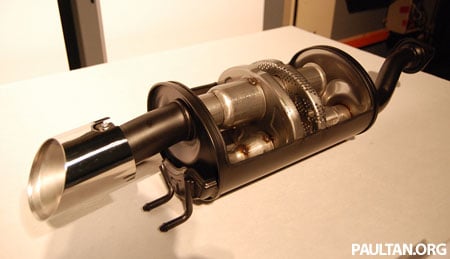

Ok, this is why it cost so much
internal of type r muffler
When the exhaust pressure is strong enough, it will push the valve flap open n become straight flow else its s-flow. U will get best of both world
http://www.honda.co.jp/CIVICTYPE-R/webcatalog/engine/silencer/silencer.jpg
hmm...
from wat i see even the valve flap open also its not dat "straight" wat....
mayb my understanding of the muffler got problem la...
but then hor...
u mentioned if the pressure is strong enuf...
how strong is strong??
any possibility dat some engine dun hav pressure strong enuf to open the flap???
thats why i buy this for trial and error lo... our punny car may not have enough pressure to push the vavle

Yours is mivec hence should generate enough pressure to push the valve open. Its not only the displacement but also the gas velocity that pushing the valve. If u interested, offer me lo... i just buy this muffler to test out only. Alternatively u can also try out stock turbo muffler but those are still semi flow all the way. Also normally those come with 2.5" inlet. Those chopshop stock muffler also many years old hence what was the condition inside? The most u can look out is those evo9 or wrx/sti muffler which is much newer. But those are like Satria GTI exhaust mounting so your rear section may not be big enough
