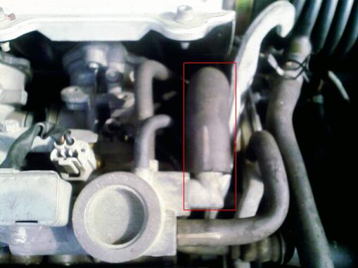

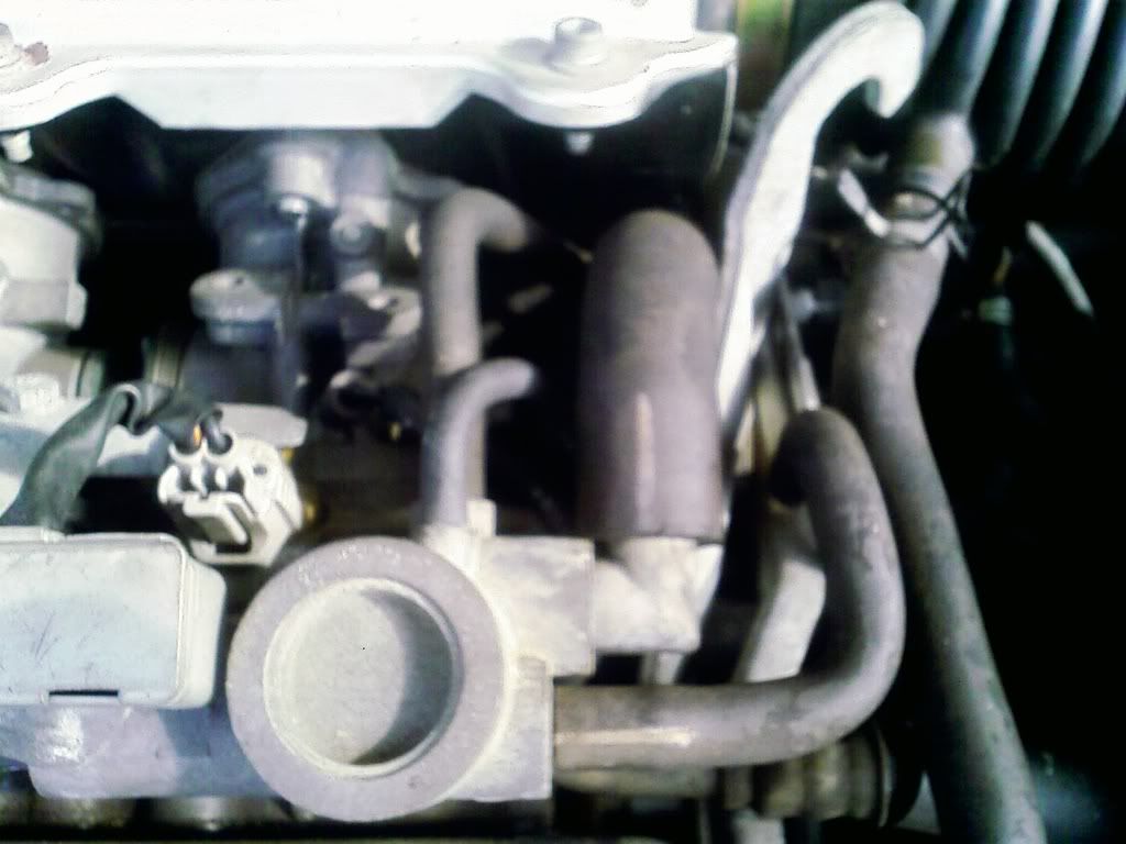

thanks chinozie bro but i have seen that... i am using a SVT and the one shown there is a BT... is it located at the same place for both SVT and BT cuz if it is, i can't seem to find it... maybe i am buta...
sorry chinozie, but which part of the TB is that? i am really a noob here... trying to learn a lil...
try to read the link carefully...there are also 2 links attached inside it...
still don't get it...
just follow this big hose (under "From" text)...it will lead you to ISCV...

still don't get it...go to you car, now...and try to locate it...
mine seems different...

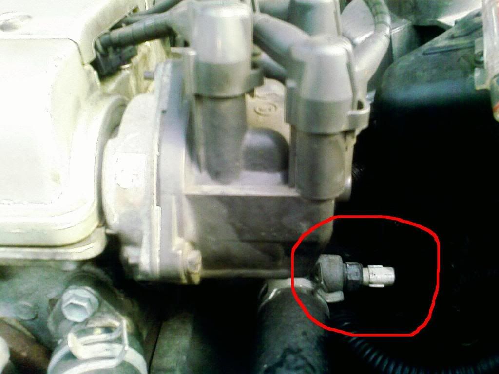

Is the circled part the oxygen sensor?

thanks all sifu here. just clean the iscv n idling improve alot
Got it figured out today... the red arrows got me all confused...
