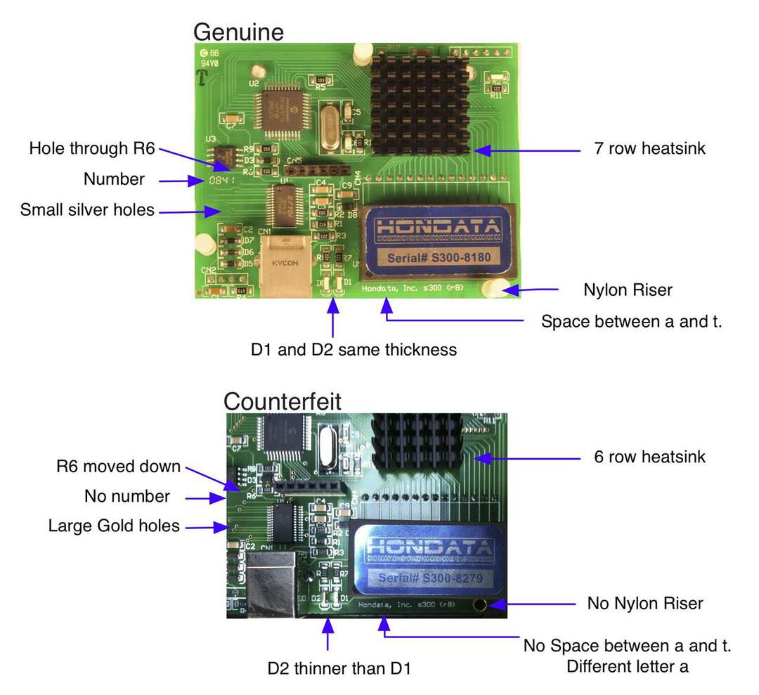

Bewere of COUNTERFEIT of Hondata product..
S300 and Kpro
walao..very hard to buy stuff..many imitation stuff..so how does the "luaran" honda ecu? means the ecu box...anyway if buy a imitation stuff got different with original one.maybe some function not same like a original one.
even if it works, probably the only setback u will experience is reliability and durability. im sure the original will be able to last longer without problems (burning of capacitors etc).

Sometime u Can't upload or download using this fake item..software also not worked properly, damaged ur engine..
One guy told me that there are 3 or 4 functions that are not available in the fake Hondata. He will only be able to tell if it's fake after installing and checking that these functions can't be used.

ive seen a hondata s300 unit which looks to be ori... coz the board color is the same and the d1 & d2 is the same...
but...theres no heatsink... at all
