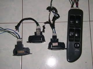

I bought door trim wira 1.6 complete wit all 4 switch.
the driver side can control all 4 window..
mine is wira 1.3's which only can control the front window only and the switch is right in midle of the console gear.
so, how i want to do the wiring that can control all the window.
plan to install the from panel first as need to buy the motor for back window next month..

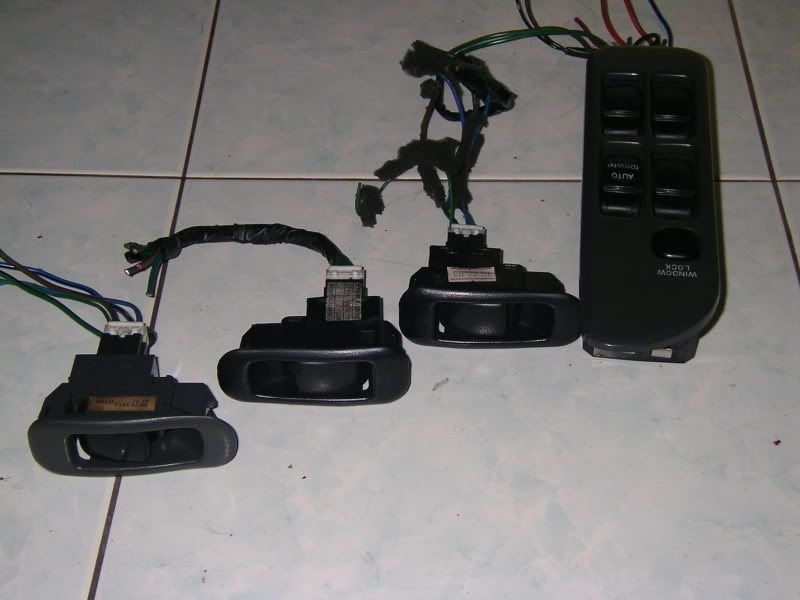

here is my switch.
1st, u have to identify ech cables goes where. ie: cable to motor or power supply or to main switch.
then, u have to "tarik" suitable and 2-4 cable (depends on switch cable) from each door long enough to the driver's door switch.
and not to forgot power cables to the mains switch with suitable fuse.
most important part is u must have knowledge in car wiring system and some basic electronic.
the hardest parts is to identify which cables goes where without diagram.,
and not to forget also, "passing" those cables thru the door and car body holes.

thanx maxx,
seems like very complicated to me..
anyway, will try with help some of my friends..
