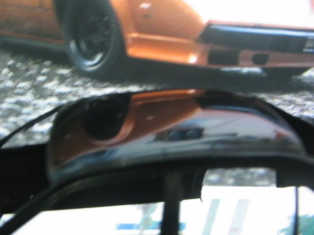

Before
We can see that the paint is uneven right ? Don't worry.....After that ,wetsand with 1200 gritt, followed by 1500 grit, and lastly 2000 grit. You will feel it smooth.Let it dry....
http://i2.photobucket.com/albums/y30/cham2020/IMG_0148.jpg
The result

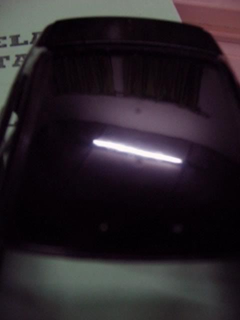

Next, use a fine cloth and use some polish cream and polish the model. Do it in circular motion till you get the shine like below....
http://i2.photobucket.com/albums/y30/cham2020/IMG_0156.jpg
Not very good photos quality though...
Cham, the 1200,1500 and 2000gritt sand paper can be bought from hardware shop ? need to wet the surface 1st before sanding right ? Also wont the paint get sand off ?what paint you are using in the pic ? Tamiya or hardware paint? how much pressure you apply to the sanding surface ? very strong or medium only.
The polish you use is those normal car polish or what ?? I can see the result is very shinny and smooth.

yes
TitanReeve,
I use from those sandpaper that are from Tamiya or from hardware shop...
And i using SOFT99 polish cream and normal polishin clothes...
