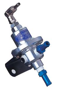

is tat meter(the glass 1) of fuel regurator got minyak?? wat minyak is tat? my regurator got minyak leak!! not petrol leak...is tat will cause the fuel regurator not function well??:confused:
tis is my 2nd fuel regurator claim in onli 1month :banghead:...is a WORK brand!!! donno the shop gv me ORI 1 or wat??? haizz...

you mean the pressure gauge (for displaying fuel pressure) or the fuel regulator itself?
can you explain what is symptom or effect to your engine? is your engine running ok/knocking/else?
- if using stock regulator, it is quite impossible to kaput as it is a fix pressure setting type.
or is it the pressure gauge that you try to explain?

YES..the pressure gauge (for displaying fuel pressure)...long story to tell, u go n look inside

Alex, i suppose you should go back to the shop and ask for the replacement. There is nothing much we can do to see your post here.
Are you referring to the oil inside the pressure gauge? Is is leaking out from the gauge?

thz wong ...i will go back to tat shop ask for replacement! yes is the oil inside the pressure is leaking out! is tat any danger?:confused:
i've suffered the same prob, just change the meter..nth serious..

from what i know the clear liquid in the pressure gauge is glycerin... this is use to prevent the needle from vibrating so you can read and calibrate properly and accurately...
you can get glycerin from pharmacy...how you get the glycerin in the meter...that i dont know...
if it glycerin then no worries...it is not combustible and non toxic...it actually taste sweet...
i've seen some FPR doesnt have a meter attached to it...so i guess it will work with or without a pressure gauge...maybe just harder to tune from the lack of some sort of visible indicator...
the small gauge is actually for temporary purpose only. after you have set to the desired pressure it is always recommended you remove that setting gauge. to monitor fuel pressure the correct way, please purchase gauges like DEFI, APEXi, GReddy or M7. (those meters have an external sensor attached to the fuel pressure regulator and the gauge itself is in the car).
The mechanical pressure gauge is for you to set the fuel pressure during tuning/setting and advisable to remove it once the setting/tuning is done.
if u wish to monitor the pressure permanently, it is advisable for you to get the electronic type such as defi fuel press meter, hks fuel press meter etc etc...this confirmed no leakage.
as for the mechanical fuel pressure gauge located at the fuel regulator itself, due to the vibration and heat in the engine cabin. the chances to get leak is very high no matter what brands you are getting.

OIC...today learn a new thing! hehe...1 more thing to ask, how many pressure tat a standart 20v svt or bt set?? the foreman set mine to 2.9bar! is tat ok? but i found my car very makan minyak ron95 rm60-250km onli:confused:...b4 pump rm50 can reach 250km

ori SARD he say no warranty! WORK come with LIFETIME WARRANTY:biggrin:

The oil in the gauge, is the damper for the needle to indicate a steady pressure than a fluctuating reading. How much u paid for it ?
I bought 1 for 35 RM from Visworks .. no problem at all.
Fuel wont leak.. but the pressure indicated could be error .. too many 100% imitations on the market... buy only from reliable sellers..

The gauge will be useful for tuning.. During dyno .. U can verify the fuel pressure doesn't drop in high Rpm..if fuel pressure drops.. u need a better fuel pump.. Hope this helps.. :driver:

i bought it at
~fuel regurator WORK rm380
~hose n clip plus labour charge all in rm450
For that price, you could opt for Tomei original fuel regulator at ST Wangan Sunway. Confirm ori because they are the authorized dealer.... nowadays even some shops in Sunway are selling fake fuel regulators. So beware guys!
As for the fuel press gauge, it usually leaks... so no need to worry bout it. My external mechanical fuel press gauge is totally leaked & dried, but still working fine :D

tat shop is a well know shop introduce by mr.levin818 to me wan...in puchong utama
...1 more thing to ask, how many pressure tat a standart 20v svt or bt set?? the foreman set mine to 2.9psi! is tat ok? but i found my car very makan minyak ron95 rm60-250km onli...b4 pump rm50 can reach 250km
just buy one set sard fpr cost RM380.00 including meter..for my SE Limited ..according to that seller NO original SARD meter produce..maybe from Taiwan/China Made..(not sure true or not la)
for my seg i used sard also (blue color) there various color in market..) with aerospeed gauge..got 2 reading psi/kg if i not mistake..easy to mech to read..
to share some experiance..
when buy fpr from that seller..he give me the display unit (not blue color) because i show him i want this sard type and then he take and give me lor..then i take lor...without think why he did not give me other set in box with seal package...after chit-chat a bit..than i say 'orait what..what u scare if you sold ORIGINAL item, if you sell good stuff i will come again (several time i buy from this shop la) if you sell fake one..you know la..your name will be gone la..sure i tell all my freind & publish on net.
then later, he offer me.."hey bro..sard got many color' what color u want...than i said what color u have..i want blue la..like mine..then he bring in the sard fpr inside the box..and i open it..look like similir i buy last time..package, seal..then..POOOOP...something come out in my mind..whe he offer me after i say that..i say 'orait what..what u scare if you sold ORIGINAL item, if you sell good stuff i will come again (several time i buy from this shop la) if you sell fake one..you know la..your name will be gone la..sure i tell all my freind & publish on net.
ha ha ha..
Work no imitation because its ori is made in taiwan, and this brand of regulator always have problem.
wah!!!same with mine 1...did urs come with lifetime warranty? how many psi ur car setup?
