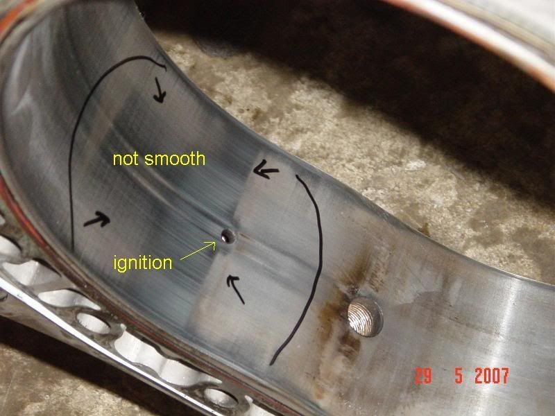

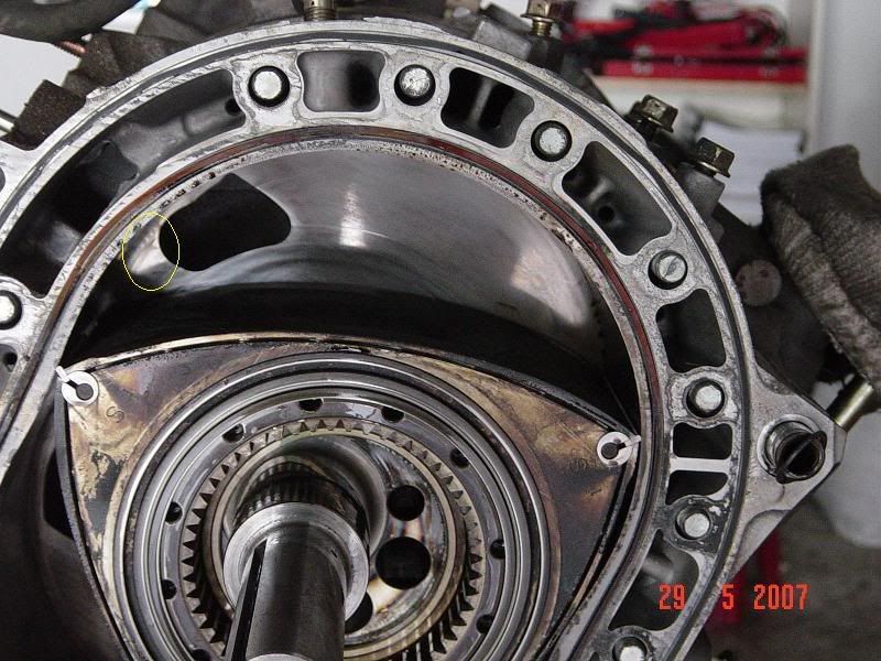

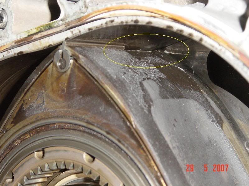

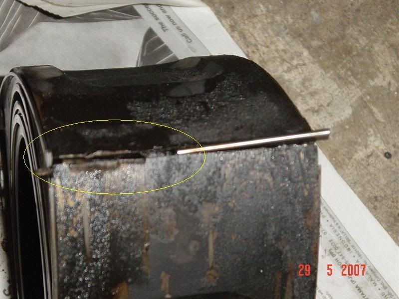

Yes, I do trash my car like nobody business. But only when there is less car on straight road. Now I probably need to pay for the price by buying a new engine due to most of the parts got damage, from the rotor to the block.
Let's say I change a new engine, do I need to put a EMU on and get tuned in Millenium?
Or, put an RX7 engine on?

http://i129.photobucket.com/albums/p221/malangsia/DSC04466.jpg
Looking for new engine :shcokedcamo:
http://i129.photobucket.com/albums/p221/malangsia/DSC04469.jpg
