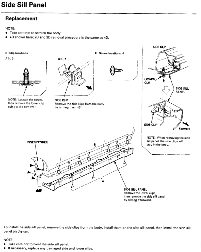

I actually trying to DIY my sideskirt. But can't manage to unscrew the last piece of srew at the back, under the passenger door side. Does anyone have the EK 4drs manual. Can anyone pls share this if you had experience it.

I'm not using any custom Bodykit. I'm trying to give it a layer of acrylic finishing to it. But first I have to remove it from the body so I can do it nicely without messing up the body.
Does anyone has this manual about the side bodykit?

anyway for immediate use, I'll post this.. but seriously, keep and use the manual, it's very handy for a lot more diy stuff.. can buy seats and install yourself, can do a lot more DIY stuff as you buy things, no need to find time to leave car at workshop.
Learn the page numbers for each section too (as you find each sections first page, where it shows the page numbers).. write it on a piece of paper or something, since the original has colored tabs to seperate each section, and the PDF doesn't. I do this so often that I remember the page numbers of the PDF file of the EG manual.. Body - page 775 on the PDF.
Lucky the older gen cars manual can find.. the newer gens very hard to find now.. all have to buy from honda UK. (dunno if the local HM stock or not)
Here's a shot from the part you want from the same PDF your downloaded from the site I gave you.
