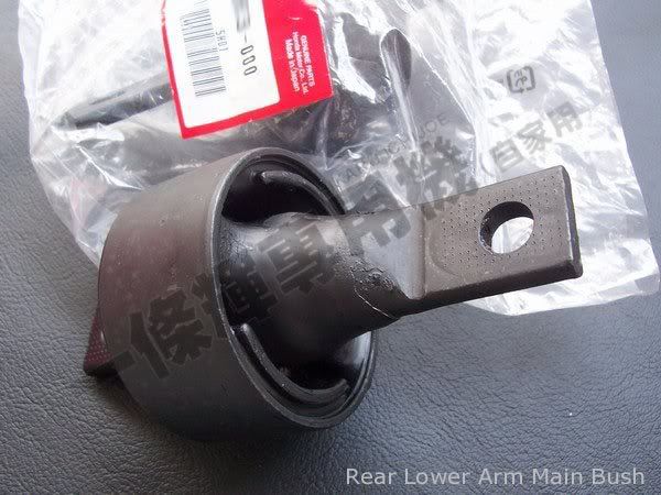

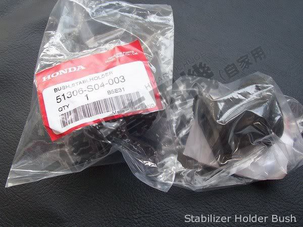

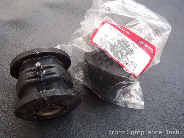

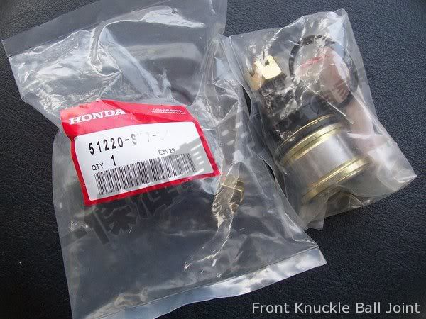

You definitely have to replace for front and rear:
a. Upper control arm (Front & Rear)
b. lower control arm (Front & Rear)
These are the other main things that you need to change as well
1. Antirollbar link (front & rear)
2. Front compliance bushes
3. Front knuckle ball joints
4. Rear Lower arm main bushes
5. Stabilizer holder bushes
Go and buy these parts at any reputable honda stockists, then have them installed at your prefer workshop that you trust.

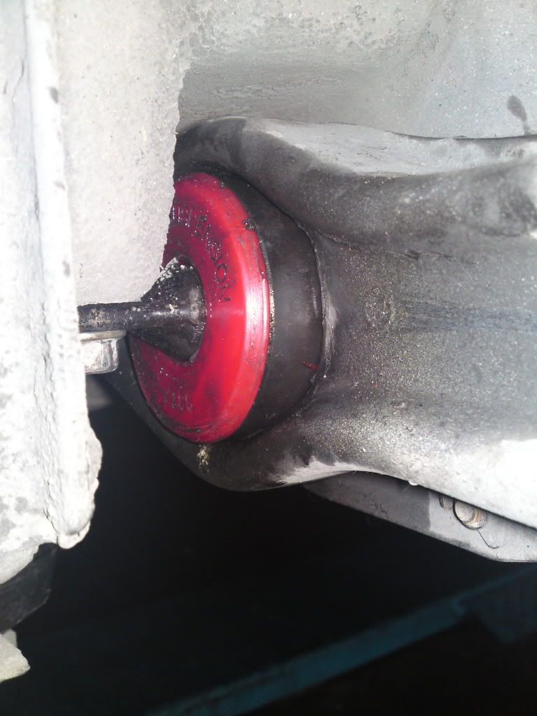

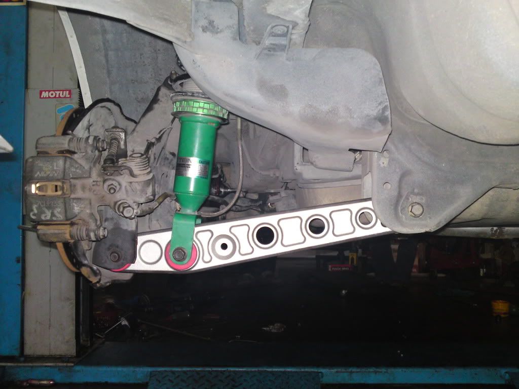

just to share my experience to all honda member...i just change my car bushing with energy bushing...those bushing given is more then superpro can give.with energy bushing u got the steering rack bush even ur tie rod end bush oso have...i can snap few pic when i free to share with u all...i oso change my rear arm to aluminuim one(not the lower arm ya..beside lower arm one) it cost me rm1600 for the product...after fix this product whole car really like new...
---------- Post added at 11:00 PM ---------- Previous post was at 10:10 PM ----------
to share how it looks on the rear side..
