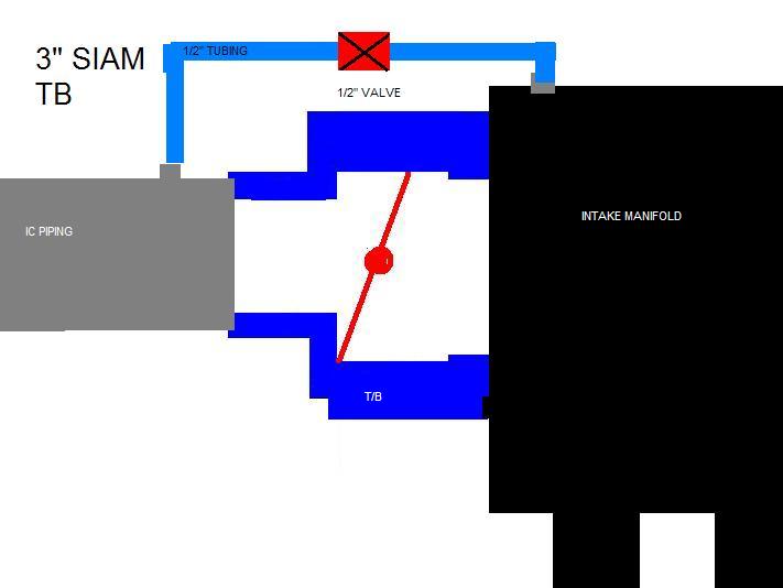

sec method to rectify this, just drill hole at intake & ic piping... than install a valve to regulate air flow while idling... this will solve the td prob.... than just close the screw at tb....

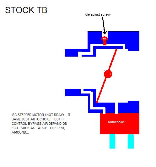

it coz of bad design of siam 3" tb dun have bypass port to control idle.... the screw just open the butterfly... so it hard to set idle, pulas siket jer dah naik 2-3 ratus rpm... coz of big butterfly inside, bukak sket pn angin dh masuk banyak.... so plz install the valve, easy to regulate idle rpm..... go to hardware shop, the valve not more than rm30 maybe..... happy moding.... :driver:

Nan, explain more abt the valve, i drill at intake manifold and intercooler piping? which part of intercooler piping? help help :nurse:

about the bypass valve.... give me some time to draw the diagram... use paint only... wekekeke

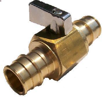

SIMPLE & EASY.... just regulate the valve to increase idle..... you also can install solenoid valve for your cold start purpose.... but please use min 1/2" tubing & 1/2" valve.... if kecik sangat, not enough air flow... nanti idle 300rpm susah... wekekeke....
