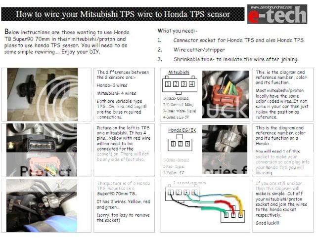

Civic713 and ManofWar and other bros that requested for this...
Below is the simple write up for the wire conversion and connection for
mitsu wires to honda TPS...
"Thank" me okay....:wavey:

thank u very much for helping me...... bro e-tech
kene charge ke...bro e tech
Charge tak payah but at least you must click on the "THANKS" icon mah....
Took 1.5 hour to prepare the instruction for you....:biggrin:
Everything also need instructions.... Here you go...:biggrin:

Can... no problem...
When completed with you new BIG TB, pls report okay.......

sorry if my question offended anyone here coz i'm still a noob
but i want to know,
why do we need to change the tps?
what is the consequences..

so ur ecu will receive the correct signal from TPS....

Thanks.:biggrin:

another noob question, how does the TB control the engine idling with the idling socket not wired?
