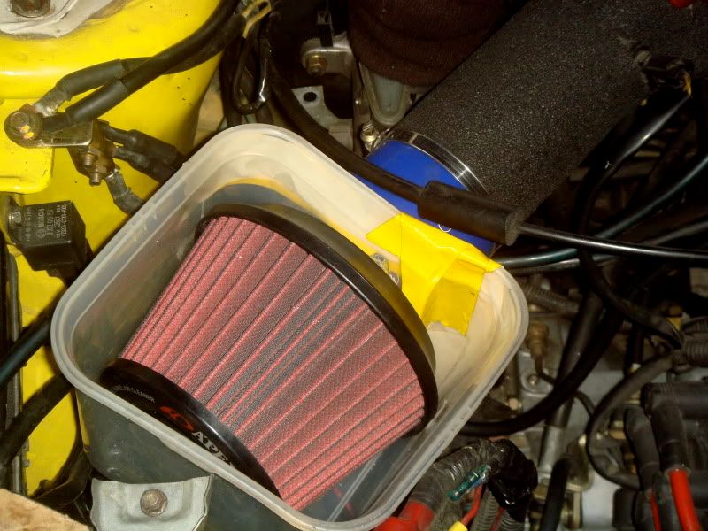

First, was the hardest to do, cut the tupperware on the side and under for the air filter and air funnel. Having it made to fit without proper measuring tool was a challenge. But good judging skills I might add....hehe. Noticed the yellow duck tape? it was giving way...so this was my solution.

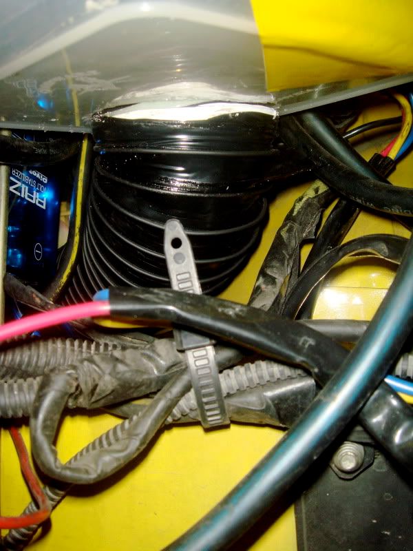

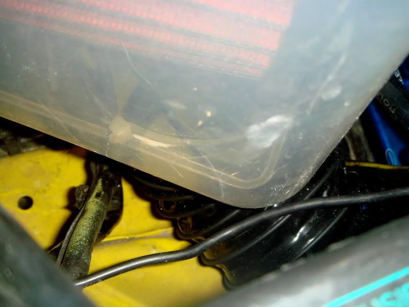

Next is a picture of the under side of the tupperware(heat shield) which the CAI hose will lead to the front of the car. You can clearly see the funnel thats tight fitted with the tupperware so there will be very minimum hot air leaks into the air filter.

Under side view

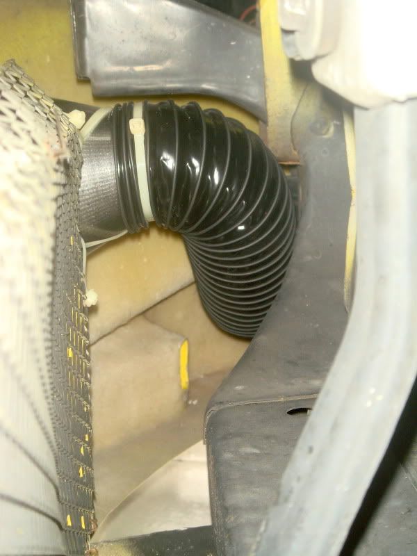

This hose will trail to side corner of my bumper and come up to the back of my front bumper. Due to irregular height, I slit 3 small holes at the apex of the hose 'U-ish' bend for water repellency.(pic not included but i hope you get the idea)

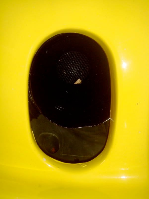

What? what the eff funnel is that you ask? its an industrial ceiling down lamp shade made of zinc i think...i had it for some years and finally found use for it. I sprayed it black and attached a wiremesh at the small end to prevent funny things entering the CAI hose. Here's the front view.
The reason i don't make a cover for this heat shield is because when i close my bonnet, the superlon underneath the bonnet that acts as a cover for it! Tried n tested n approved! Plus, its good to have some air circulation rather than have the air filter breath thru a straw all the time right? Anyways, when moving, can say most of the air sucked by the filter is from the CAI.

Under side view
