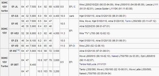

mine are 850 carb MT.. yeah man.. just want that extra torque abit faster than stock but high efficient and endurance as well..
make sure u do more research on your JB-JL/JB-DET selection.. get more info from sifus. i might be wrong bcos i'm no sifus. still learning.
but i can say i have quite experience with EF-JL maintenance n mod. i think u can go search for EF-RL/EF-DET engine. said to have slightly
more torque than EF-JL since its a DOHC combo with 3 cylinder. check this table.

yup.. EF-DET/EF-RL has the highest torque for E series engine.. depend on how u drive. if u drive it long distance, get JB. if its just a city drive, get EF.. 4 cylinder smoother and alot less vibration. thats why EF-JL (L2s) shaking alot at high speed.
