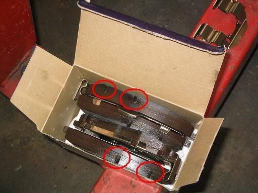

How to check when the brake pads are worn out or due for replacement? Any DIY guides from all sifus here...
dartango,
1. Ask the mech to check whenever you sent my car for engine oil service, check only, FOC. :biggrin:
2. stop your car, check the "longkang" at the brake pad. if you still using the stock brake pad, there are "longkong" (2 at least) on the pad, it's 1 of the indicator for brake wear.

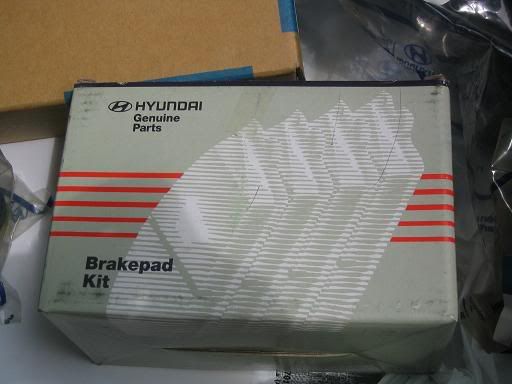

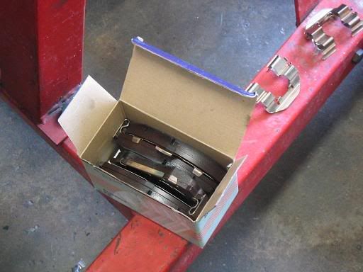

Check this out, brand new Genuine Hyundai Coupe Tiburon (RD1) brake pads , and compare the "longkang" with yours, errr, i mean your brake pad. :biggrin:
far view
The box
of course if your brake start giving you noise, time to change as well.
