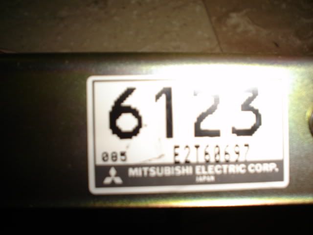

alopz monmon ur 4G93 izzit from the galant family?
whereas the ecu code is MD316123?
izit like this?
can elaborate to me ur experiences wit this engine?
