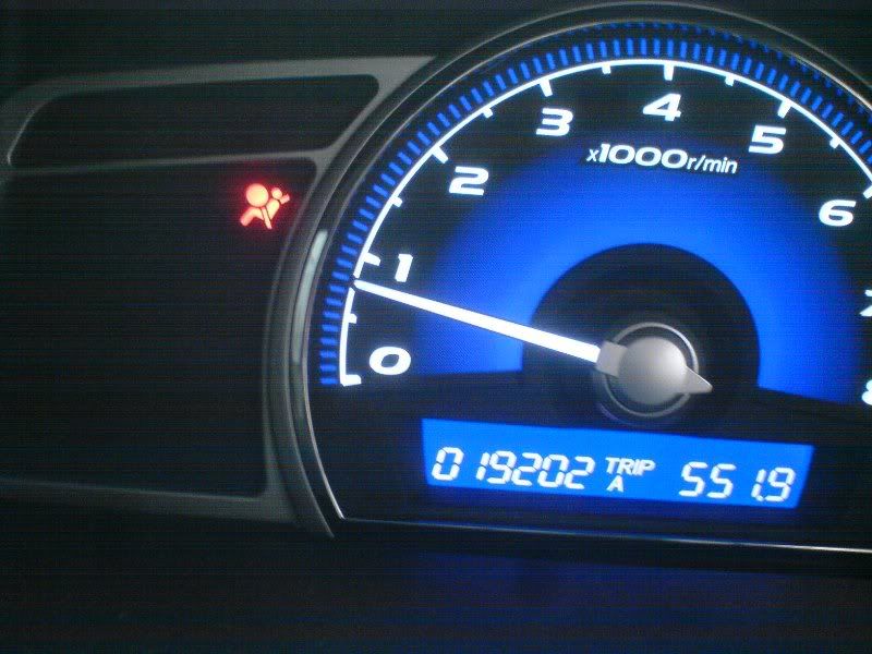

since FD2 go side SRS Air-Bag as standard, while the FD2R didn't. now, if u change ur seat, the SRS Airbag for whole car will be disable. will see the SRS keep blinking.... akakkaka....
or u still keep the sockets/sensors attached to ur oem fd seats, lengthen the wires, then place those seats in the trunk,...
can liao,...
SRS still function, and u can sit in the CTR seats,...
can liao,...
how to fit this problem..the seat airbag lamp blinking
