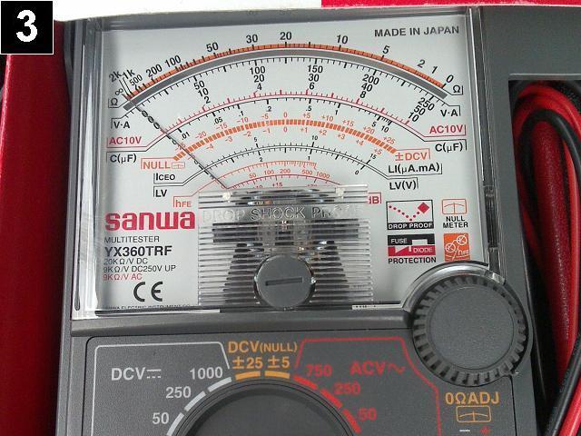

3) Get an analog multi meter (any brand can do)
4) Select to 2.5Vdc range

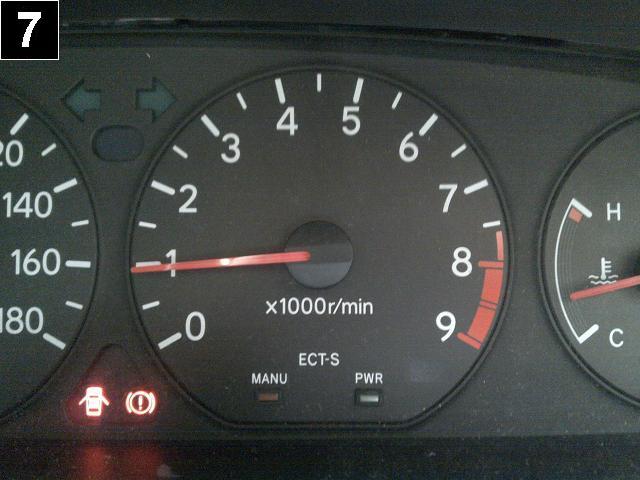

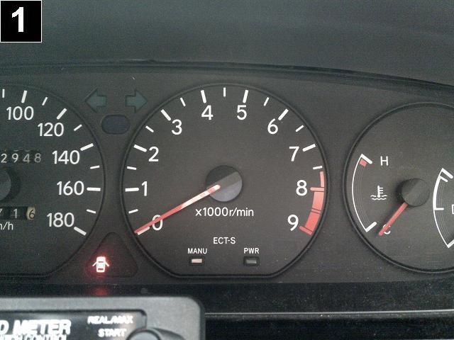

7) Start your engine
8) Wait till it reach working temprature
9) Keep your RPM at 2500
10) Observe you multi meter's needle. It should be moving up and down, from 0 to 2/5 of full scale.
11) Time your watch, a good O2 sensor will move the needle up and down for at least 8 times in 10 sec.
If your needle move less than 8 times per 10 sec, or idle at any scale, your O2 is dead.
