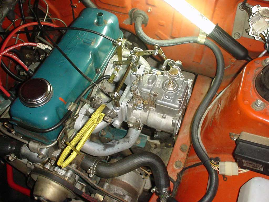

fstrader said:
you did not do some research first b4 getting a weber kah bro? yes there is mini's with 3 cyclinders using single dcoe, and yes it is HIGHLY not advisable to use a single dcoe on a 4 cyclinder engine....
dcoe's are for race and drag purposes, and can only be paired up using 2... below an example of my previous DCOE :p :-
http://i2.photobucket.com/albums/y3/fstrader/5808weber4.jpg
fstrader,,,where did the trumpets gone ? can you get correct setup without the trumpets,,,must be "gila" to tune rite:regular_smile: . IMHO the engine must lost low to midrange power coz of no trumpets.
allo v8, photo taken on da side maa, dats why cant see da trumpets. fyi it is with trumpets.... not much tuning difference if without the trumpets, only thing noticeble is da sound is gone ehehhehehe..
below da trumpet photo :D
http://i2.photobucket.com/albums/y3/fstrader/5808weber3.jpg

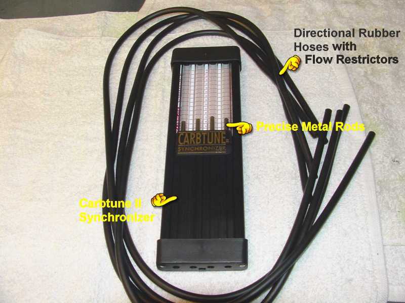

try to look on the net regarding carb balancer..it will be great if we have it here or maybe DIY it....hehehehehe...
