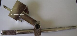

well... i saw an advertisement in car mag.. i think PowerZone or something like dat... they got sell a short shifter kit.. this kit comes with 3 things
1. the shifter shaft itself
2. another lower shaft connected to de main shaft above
3. and the base with higher pivot point
i noticed dat de ad short shifter got a longer shaft at de lower part (bout 2" more)
and also de base's pivot point is bout 2" higher than stock
so now my question is wat do u really do to modify the stock shifter??
do u make de pivot point higher by extending de base "thing"?
mind to share? i mean A-Z... here DIY thread mah.. :)

You got the cutting place correct, but cutting and extending alone is not enough. The Pivot point need to be raised at least 2" so this means you need to cut the whole swing platform and extend there too to give space for the lower shaft to move freely without obstruction. Some more trimming is required on various places to make room for wider swing radius, you will need an angle grinder to trim them up.
