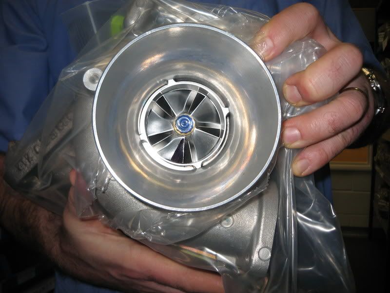

we have this coming in soon :
For EVO-8 / 9 : TD05HR-20G-BB (customised ball bearing) with 4" ported shroud compressor inlet.
Which one is bigger, this sucker or the FPGreen?
Is this mitsu/gt30 hybrid?
Heh heh...
Ermm.... I dont think soo.
The FP Green not soo popular here. Mr SDF is good in promoting his stuff!
