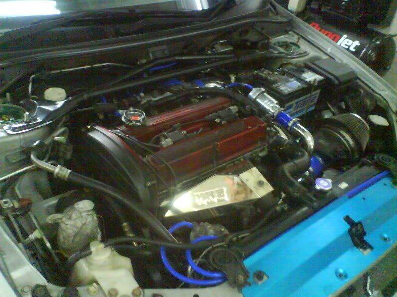

My Evolution 7
Block stock standard ....

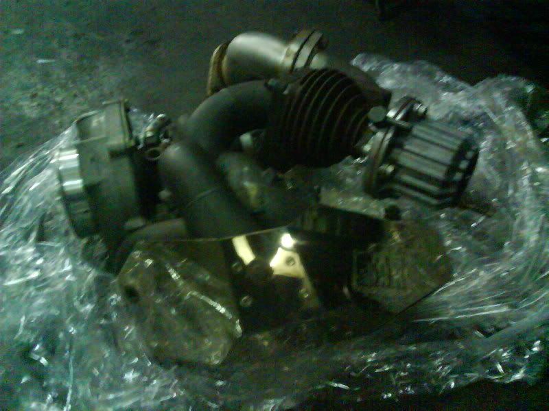

HKS 3037 Turbo kit...bought from Vincent from N1 Racing ...2nd hand
Tomei 270 lift 11.25 cam
BC Oversize Valve
BC Titanium Valve spring and Retainer
1.5 Tomei Metal Gasket
with Sard 800cc injector
Running with Apex'i Power FC LJetro
Port Polish Head
intake all standard .....
this setting Laggy hell ...turbine kick in at 41xx RPM Full boost around 5xxx RPM
Last dynoed at JC Racing 426whp torque 46 boost at 1.5 bar 77xx RPM
My turbo kit
