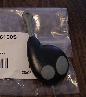

Yeehau86, not the device looks like pen one, this is normal round shape device that you press when you want to unlock you car before entering it. Sorry for my ignorance, i dont know what they call it. (See attachment). Please help.

that is the same alarm in Toyota Vios, Altis, Honda City, etc are using. But how come need to enter code? usually is just press the remote and enter :confused:
if it is the round thing, then it is less troublesome as you can duplicate it. It is called remote :biggrin:

The things is, mine is different a bit from others. I dont have any so called device which look like pen (as your posted pics). Yes i only have the remote, just like Toyota. It is critical important (the remote).
Normally, I just press the remote button, the car unlocked, i poke my car key, and turn it until the battery light is On, then i will have to enter the code, after that i can only start the engine. Without entering the coded, i still can get the engine start, but only can go around 1km, then the alarm will trigger, the car will stop.
Do anyone knows this kinda alarm/immobilizer before? Yes it is rare. Without the remote, it is impossible to drive the car. And so far, i just found that only car uses this immobilizer. Bought the car from previous owner, it was already installed.
