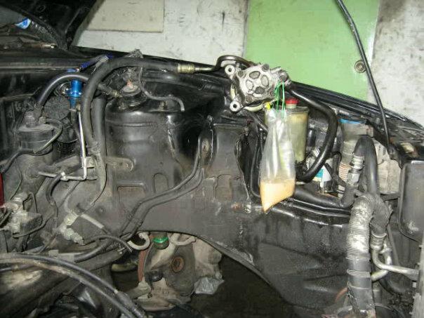

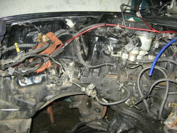

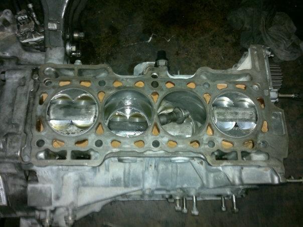

I would like to share some modification to my friend accord sm4 that use H22A engine take from BB4 model.Here some picture for early stage...

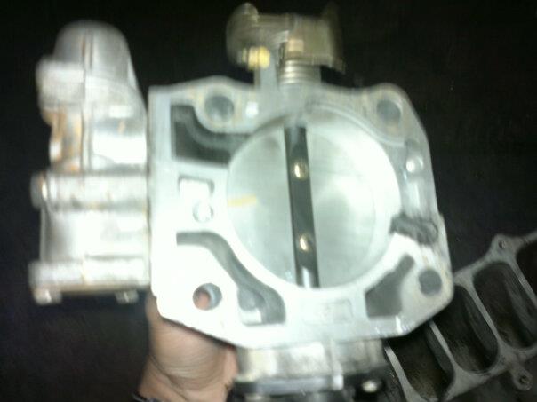

Clearing engine bay...

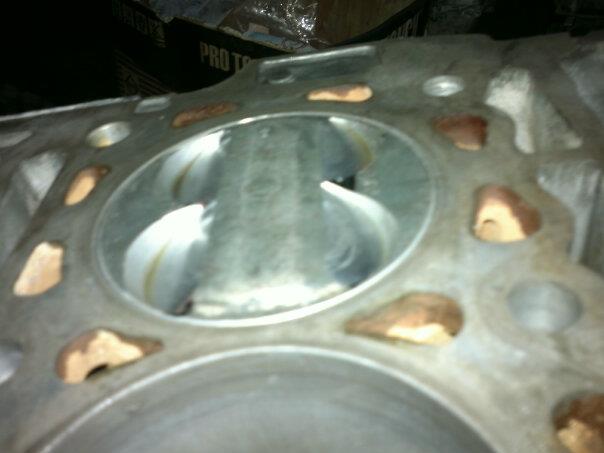

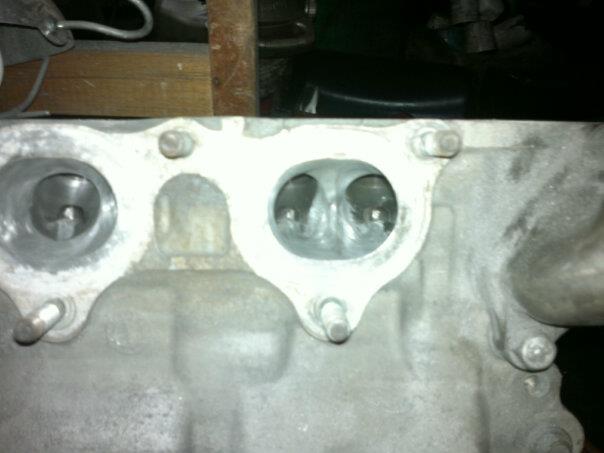

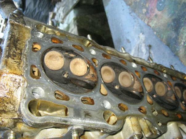

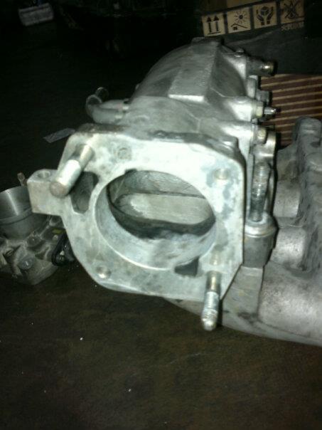

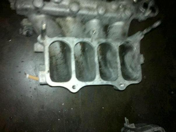

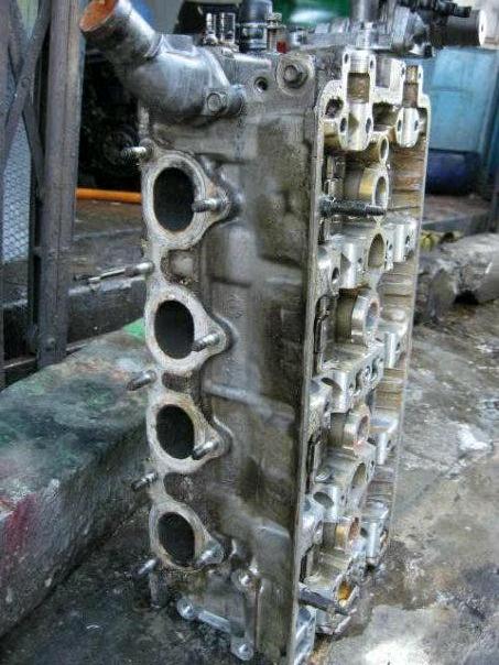

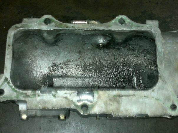

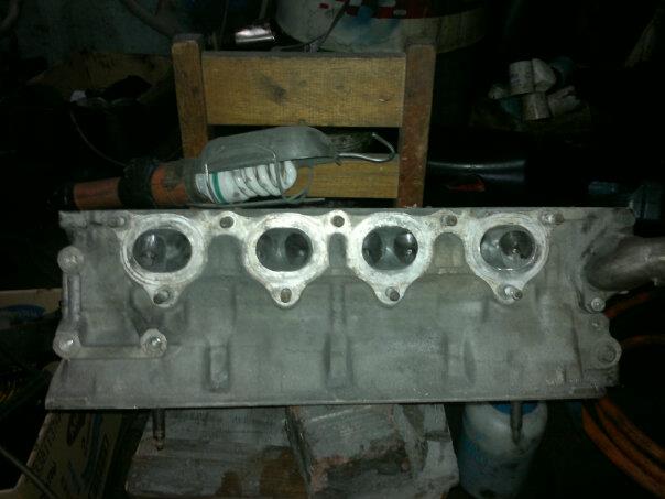

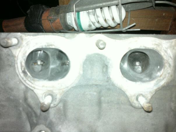

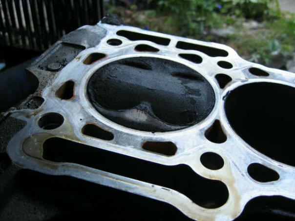

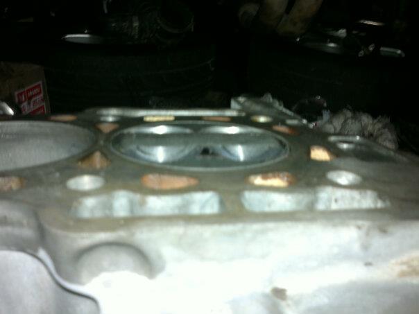

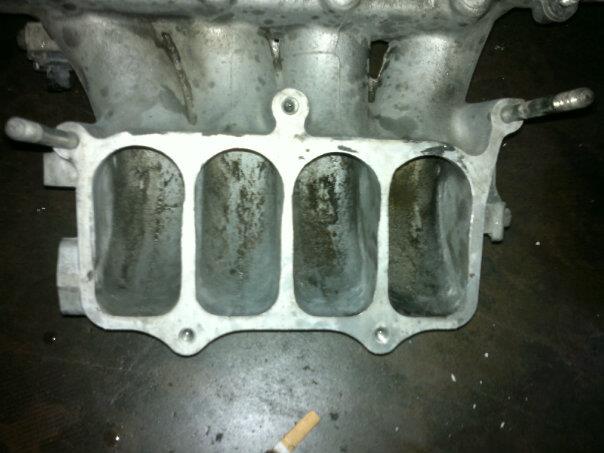

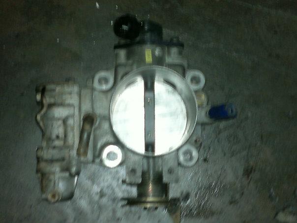

Engineering that have been done including port and polish...

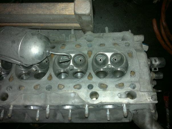

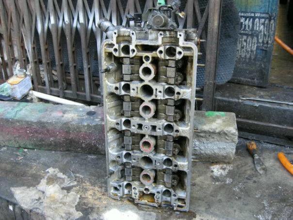

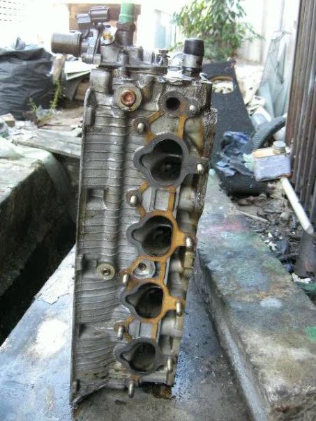

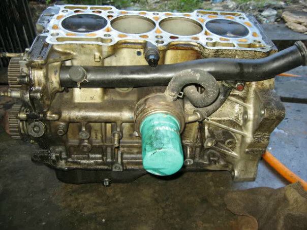

Work on head...

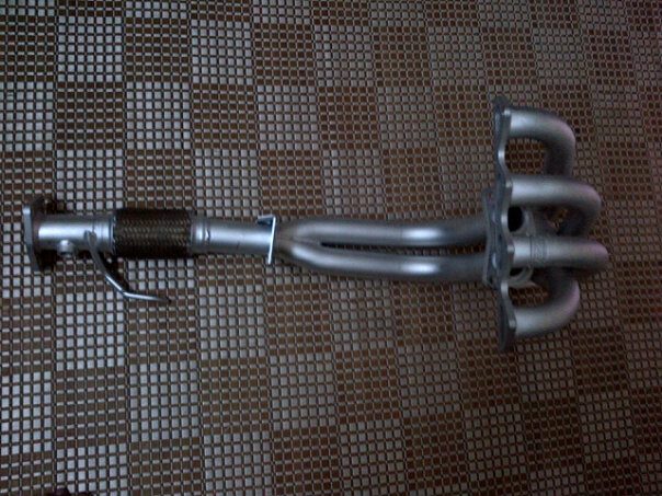

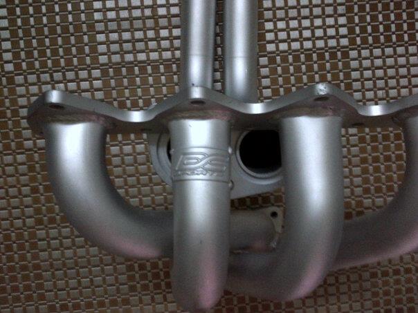

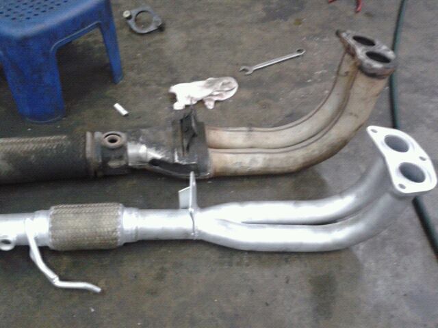

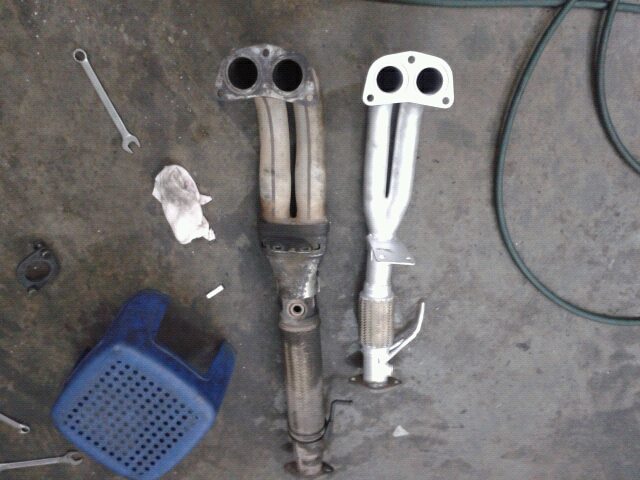

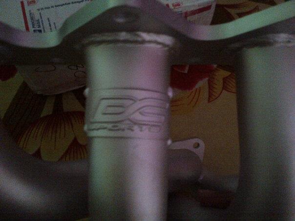

New extractor from DC Sports arrives last week...

Nice... wanna see more.
Bro, where and how much your friend bought the DC Header?

That extractor cos me around 2k.

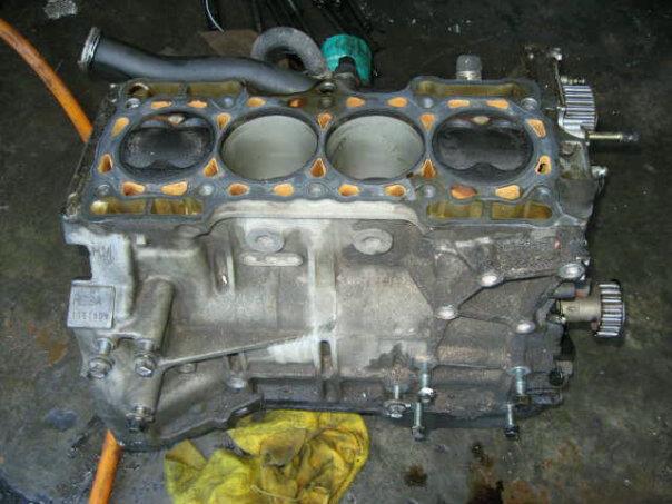

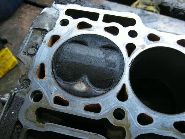

I just modi origanal piston.
For cam plan to use jun stage 3 with supertech valve spring and retainer.
Cam pulley use skunk2 taken from my h22a.

What you mean by mod the piston?
Still learning here.
Piston send to engineering custom it looking like cp piston...
Not enough money to buy original...hehehe
Oic. You mod the piston meaning you increase the compression?
Will there be any negaive effects for doing that?

Yes the piston i increase the compression.
So far because of using oem piston with proper engineering i have no problem with that kind of modification.
My car use the same method and i use it for 3 years already.
Difference only mine use euro r piston(red cover) and the one that i show here use standard piston(black cover)...

what he really need is hi comp piston to match with JUN camshaft.. my advise, better do compression test first before decide to use hi cam..

What you mean that i need to match it with high compression piston?
Can u explain it...is it wrong with the piston that i choose?:-)

We try to use h22a from bb4 body as our based,try to not change the intake appearance and the engine itself..
We also upgrade and focus more to head above only and some minor counter for piston and others...
Piston we maintain oem that have 10:1 compression and send to the engineering to tapper the valve area for clearance and mod like cp piston meaning that we cut some of the bottom piston...
Like you antuquboq you have 11:1 compression piston same as mine...
