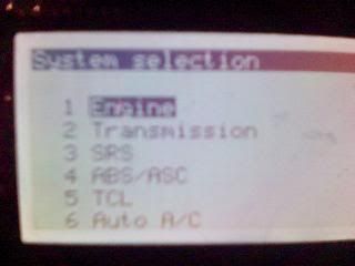

some pic.
Hmmm... diagnose tool?

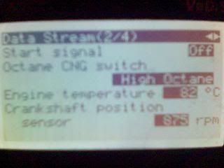

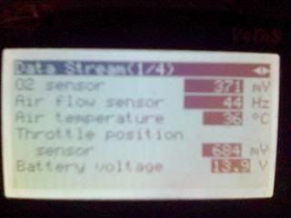

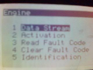

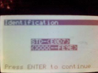

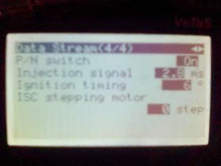

you got the diagnosis tool? is the figure shown is after tuning or before?
my uncle punya...
my car absolutely ORIGINAL:_:
no mod no tuning.
jimmy_WAI said:
my uncle punya...
no mod no tuning.
