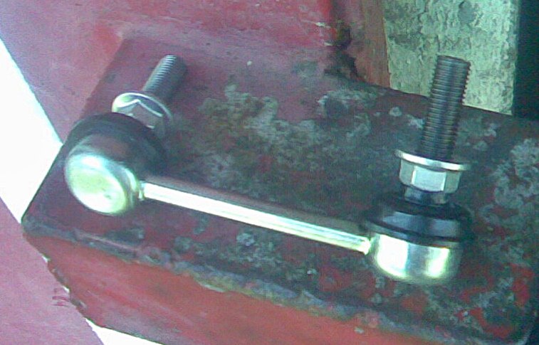

Today went to my mechanic and ask him to shake the car kuat kuat to simulate the noise. Thankfully this round can shake because with new shock, its softer and shake easily. Found the culprit... Its the stabilizer bar link. Some call them absorber link.
The parts cost RM58/pc with 555 brand. Purposely go try hit the bump and so far no significant noise la... Hopefully it solved.
