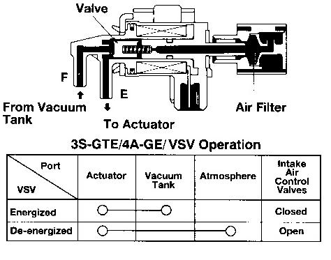

This is how the VSV work for 4AGE:

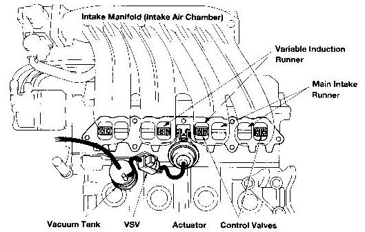

This is where the VSV allocate at:

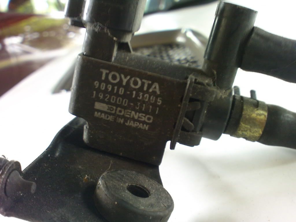

Yup the 2nd picture is VSV for EVAP...
but what is the 1st picture ? for sure it's a VSV...for sure it do control A/C idle-up for SVT model...but what VSV ?
==========Update==========
Heee...being told already...it's VSV A/C Idle-up
"alamak...sudah salah :D"
VSV for Evap...it connects between air cleaner and Charchoal canister (can be found in BT Repair manual page F1-62 under Electronic Fuel Injection - VSV for EVAP)
P/S : the 1st pic is (part #90910-13005) VSV for MR2 year 91-94...

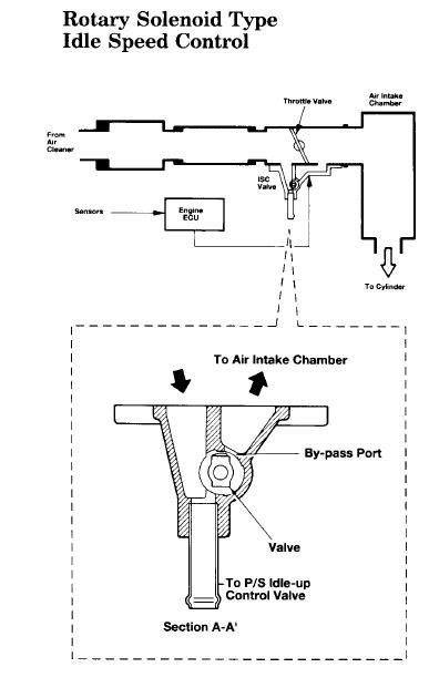

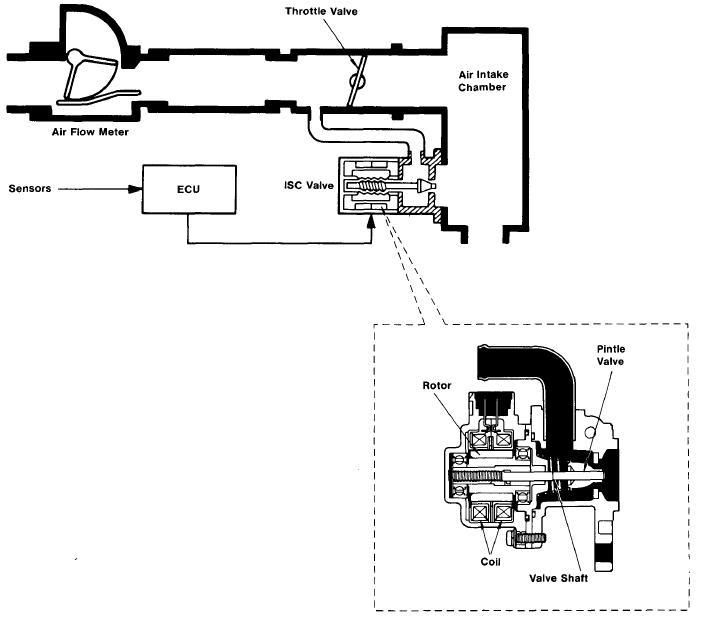

20V ISCV is Rotary Solenoid Type,not stepper motor (Chin u already confirm this before,hehe).Normally all rotary solenoid ISCV have 3 wires (some only have 2),and most Stepper motor ISCV have 4 or 6 wires. But i am not sure why SVT have separate a/c idle up vsv,while BT done have,maybe their ISCV airflow capacity is different.Chin can u research the part number of both SVT and BT ISCV..

this is the real 20V ISC system
