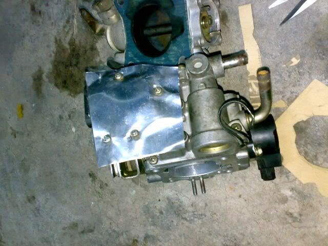

Im getting upset with my TB usable life, use for 2 years, then its kong again. rev up high n down erraticly. thanks to the plastic ISC.
then i decide to use my tb but with some mods, no isc at all. its the isc that keep broken and i had to buy whole new set of tb again.
I have experiment my modded tb for 500++km. im really satisfied with it.
Just want to share with all forumers.

bro, u totally remove the ISC unit means there are no longer any controller which controls ur coldstart and a/c idle rpm... unless if u have standalone/piggyback ecu to control it, it is not recommended to do so... or, i could use toyota FICD to control ur aircond idle rpm...
what i did to protect the bottom ISC unit was a crude heatshield...

coz the black plastic ISC is sitting on the coolant return line (direct contact) which runs into the throttle body... datz why the coolant line heats up the plastic and melts it... exposing/damaging the circuit inside.... datz why i made a heat shield which at least shield it from direct contact with the hot coolant line...
FICD can cure aircond idle problem... what about cold start??... does cold start has anything to do with throttle body ISC??...

1. there is no thermostat-look-alike thing in the tb. try dismantle everything. the water just run thru it.
2. if you own a wira, there is a problem with the TB, when you slow you car after normal drive (eg wanna make a u-turn), the engine have tendency to stop. FICD will fix this problem.
DIY - Install FICD :: Fotopic.Net
3. about the heatshiled, either you make one or bypass the coolant hose
DIY - Throttle body tips - Coolant Hose Bypass :: Fotopic.Net
