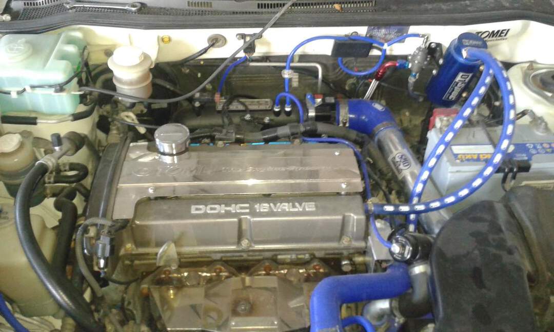

skunk2 intake, fuel regulator, arc plug cover, FMIC + piping, BOV, oil catch can.. oh and long list bro..
btw, skunk2 intake for 4g63 evo/airtrek?

fuel rail, oil cap:biggrin::biggrin:

Yes its a skunk2 inlet manifold for evo but you need to change your dipstick as well to evo which is not in the kit and a decent thermo inlet gasket you will need as well :driver:

seems like exhaust header also not standard :biggrin:

Power steering fulid not black its red all my oil's are motul accept gearbox oil which is mitsubishi sp111 and i am changing all my oil's every 5000 miles :stupid:
