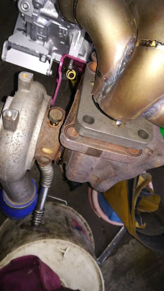

Well back to engine progress, today i received my custom made Banana or Manifold. They weld it perfectly, but for the flange i asked them not to fixed weld just in case i need some change on piping layout when installed. I certainly want to avoid cutting my engine front bar or bumper to install the turbo. The banana was powder coated to reduce rust.
The cost for the custom Manifold + Powder coat is RM1100.

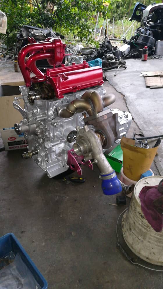

Update as of today. My Mechs start doing the fittings. We planned for the piping arrangement for the turbo and intercooler. Might be some cutting from inner part of the bumper to give the banana and turbo a space. Those new nut still not install to the engine as i send it for anodize gold colour. Engine bay will be painting tomorrow. Will be update again sooner.
