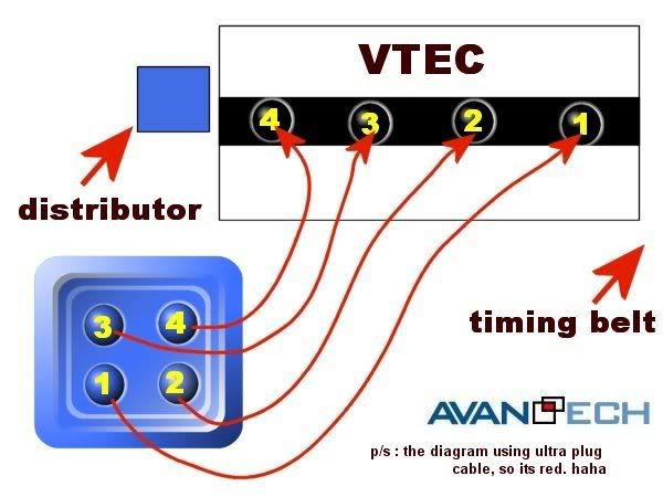

if u stand at the side of the driver side fender and look at the distributor from a "Z" sequence it should be 3-4-1-2

Updated the pics
I know the marking C on the distributor is the 1st piston...looks like this
when you are looking from the air filter side
3 4
1 2
but i know different workshops has different sequence...
So who knows which is the right one??

EGfan said:
Updated the pics
3 4
1 2
wah... different wshop different sequence?
i think honda only allow one kind of sequence..
only sometime wshop view it from different angle. i think thats what u mean. rite?

hattech, thanks for the diagram. if not 3-4-1-2 then cant start is it?

Yes hattech, thats the one i'm using... Shall stick to it then...
thanks guys

EGfan said:
Updated the pics
3 4
1 2
this is correct!!!!
