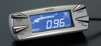

just wonder what are the minimum require metering stuff for turbo engine and its function?
1. Turbo timer --
2. Boost meter --
3. Oil temperature meter --
any else and pls tell me which one is a must to install, thanks..
