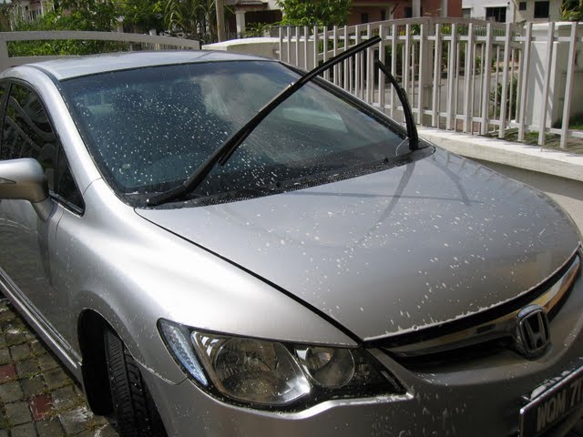

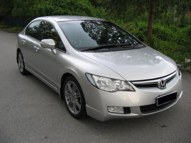

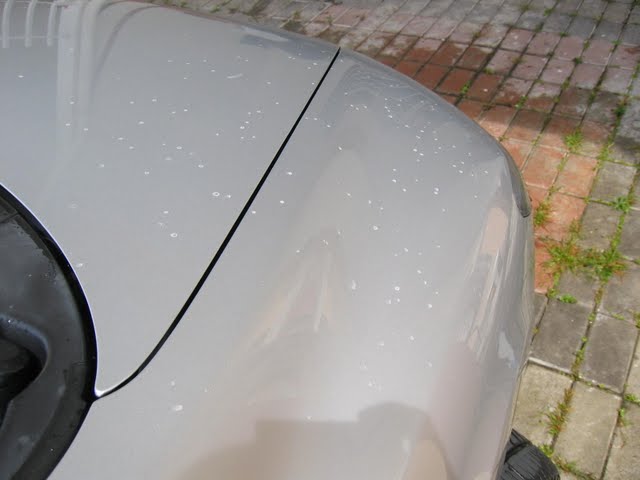

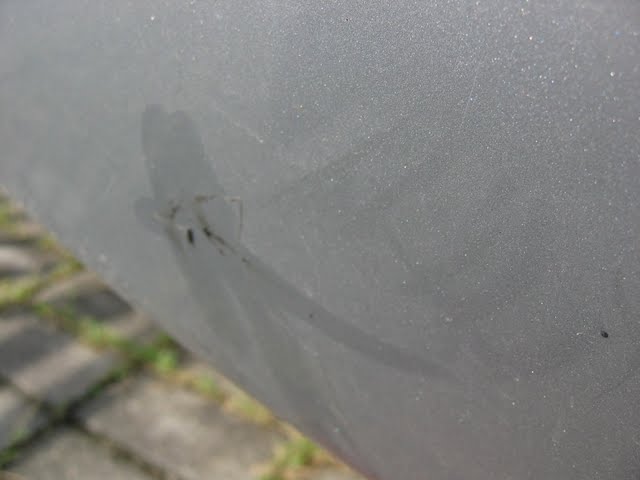

I got a distress called from my neighbour that his colleague car has splashes of acid causing the white spot on the paint surface
WATCH out for these guys..(M'sia A/C usually fitted on top )
..picure for illustration used only
I should not have meet up with him at night & as many thing wouldnlt shown up under street lamp & bad finding. Deatiling appoinment set for !st Jan makr a begining of a new day for a new year
I got a shock to find out what actually happen under day light when i saw the car, the acid splatted actually corroded the car paint.. will elllaborate more

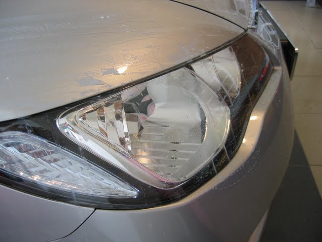

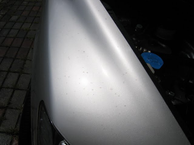

here are some of the pics of the Spotted leopard -

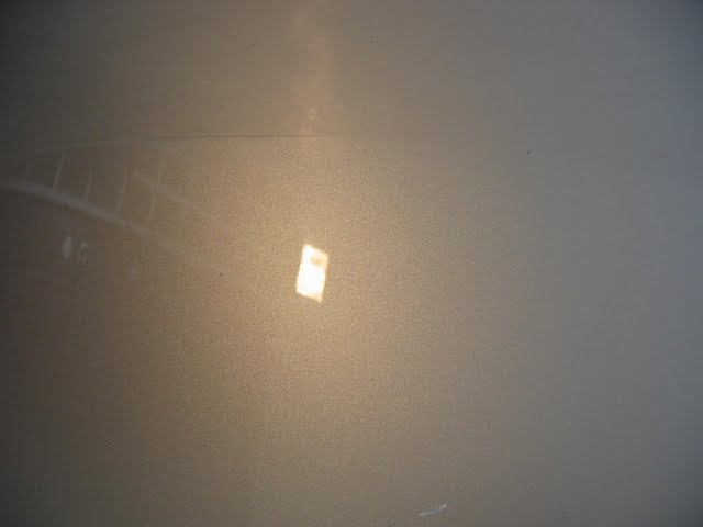

some paint defect pic discovered along the way (pics Before)

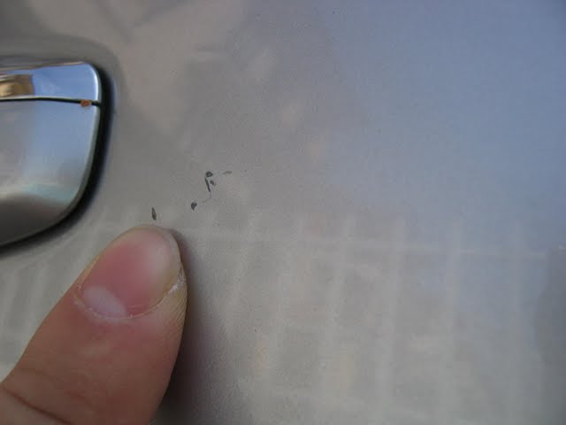

paint chiped
some stains
left side rear bumper ...evidence of chewing gum stick till the rear

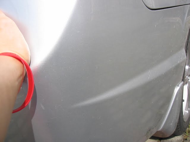

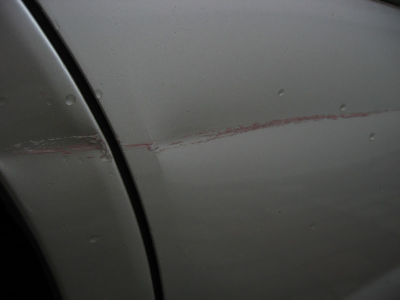

rear bumper scratches
some scratches before corrections

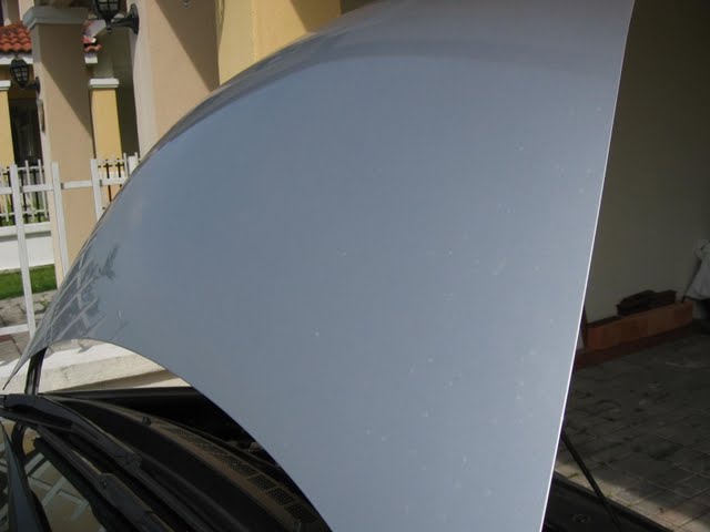

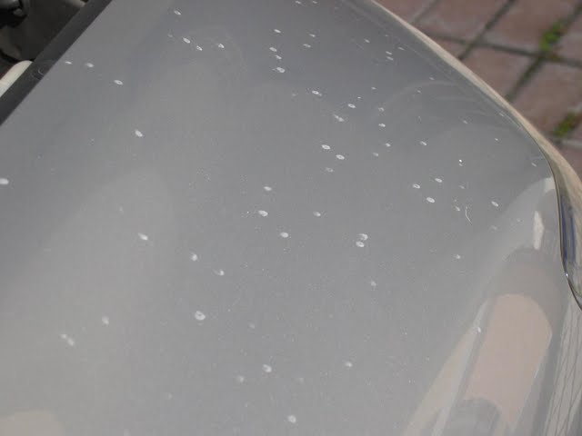

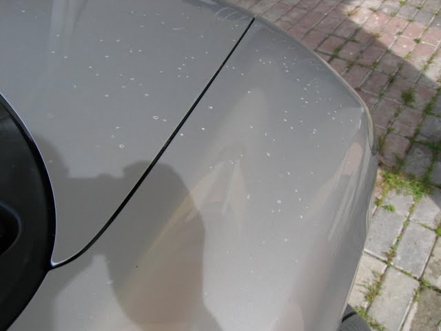

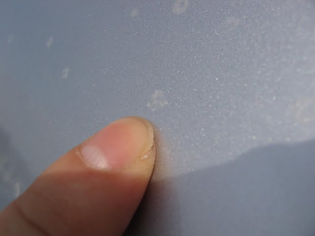

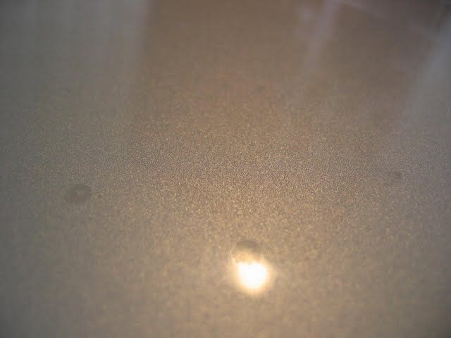

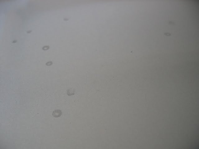

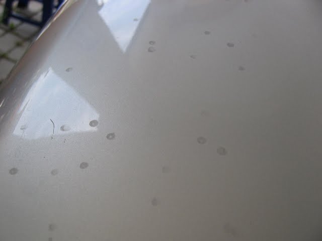

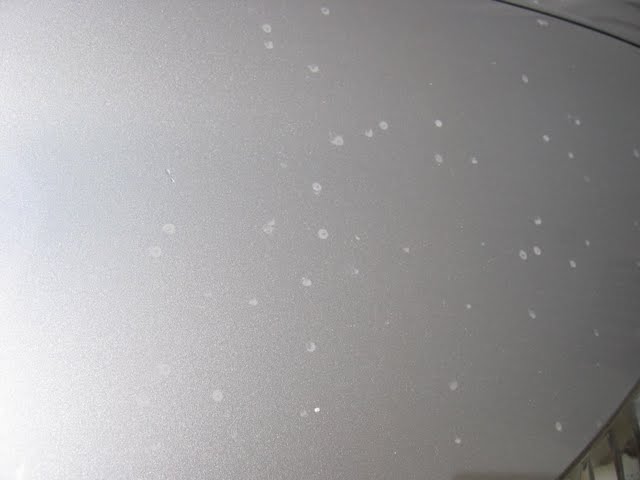

More evidence of the spots

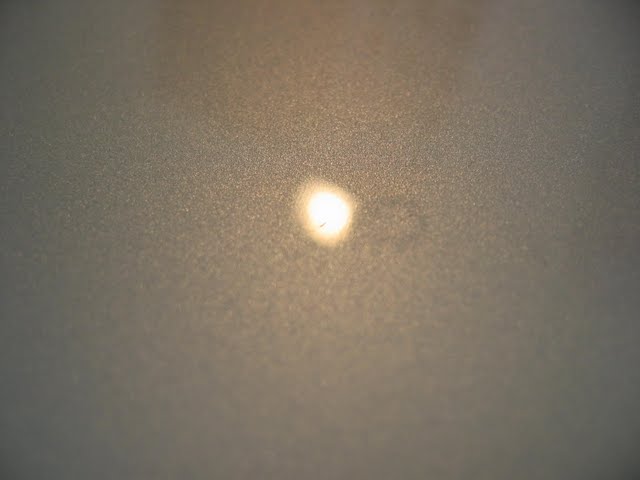

if you see carefully u actually these spots actually look like crater on the moon
closer pics
My Rescue mission is to lose the spot on this leopard
Aim to get it corrected & restored

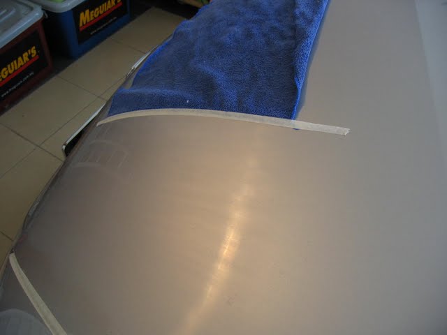

initial test Meguiar's #80 - Speed Glaze polish with Cutting Foam Pad on Rotary & upgraded to a more aggresive DOuble sided wool pad still not achieving the results i want, Then I call to discus the severity with the owner & advising him the details & damaged - resorting to wet sanding -
if i continue to compound, i may damaged this soft clear coat & the intense heats actually melts everything else.... he says go ahead to do the rest & i Wetsanded the whole bonnet - 200 unigrit sand paper

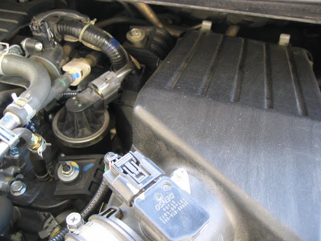

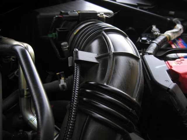

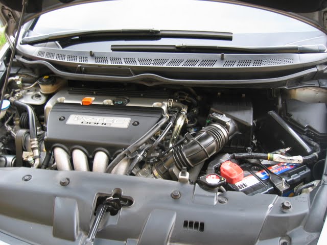

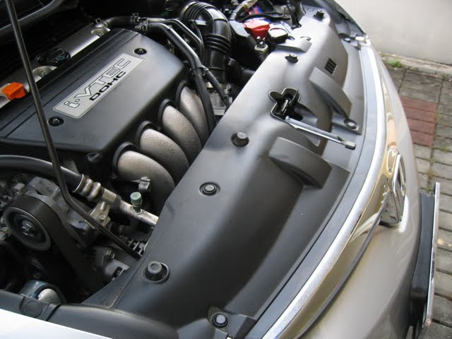

some engine pics before

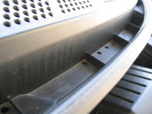

stainted water marks on the plastic well

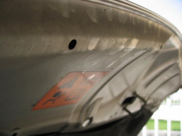

Bonnet pics before

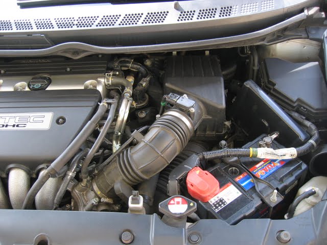

engine after
close up after engine detail

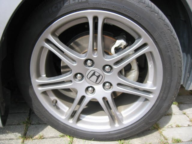

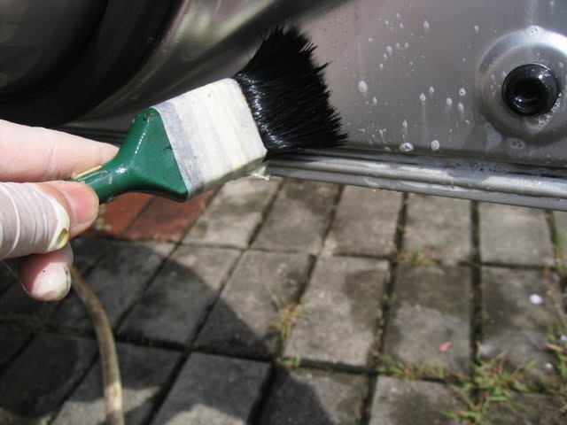

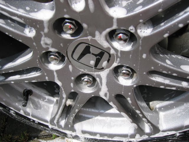

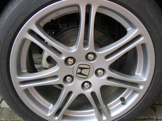

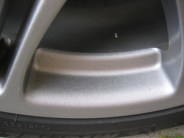

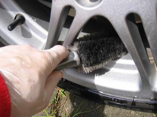

wheel before
APC agotating at work
wheel brush
now a clean wheel
the detail of a clean wheel

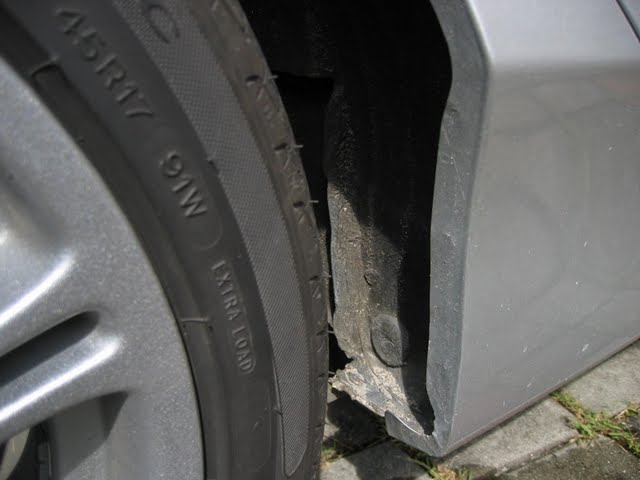

wheel arch ...before

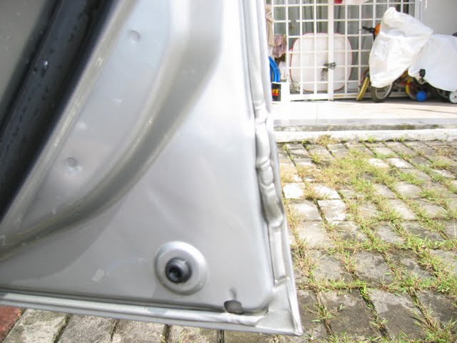

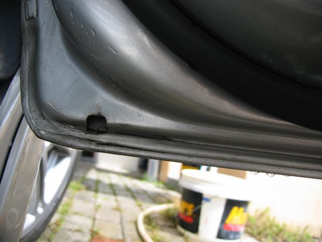

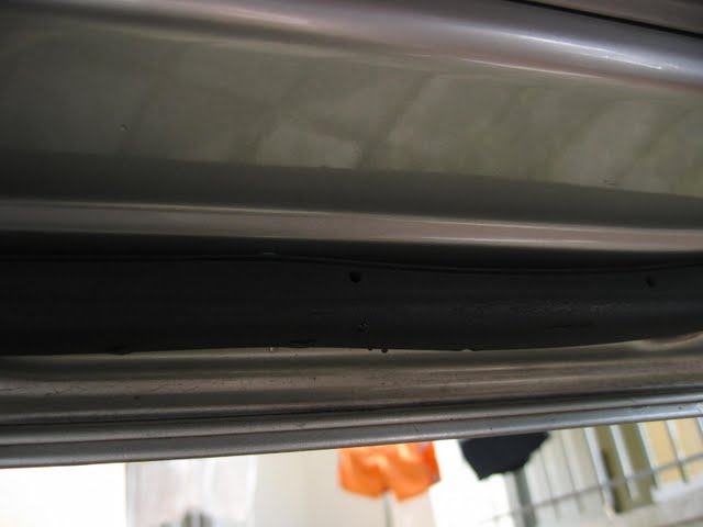

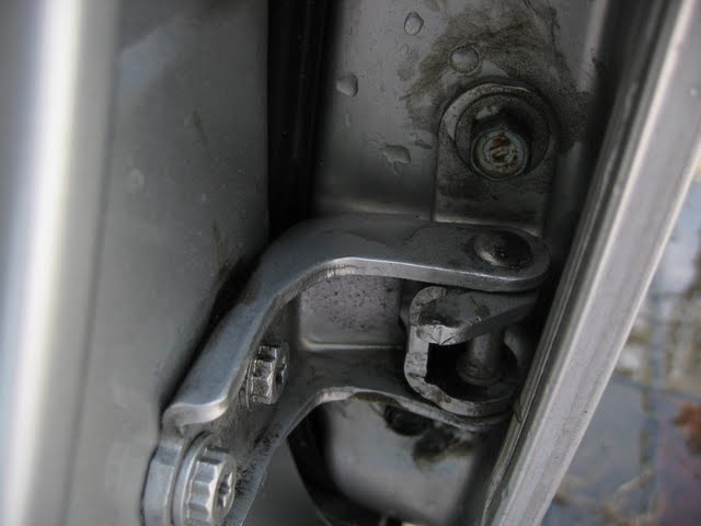

door jam before
after & the residue is buff away with AIO Meguairs PRC D 151

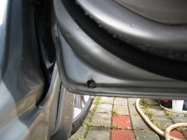

pics before inside door area
during agitating
after pics
before pics
after

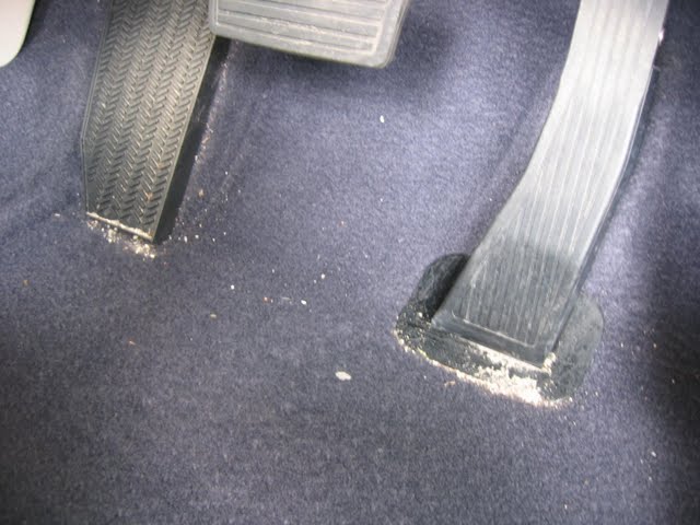

interior before vaccum

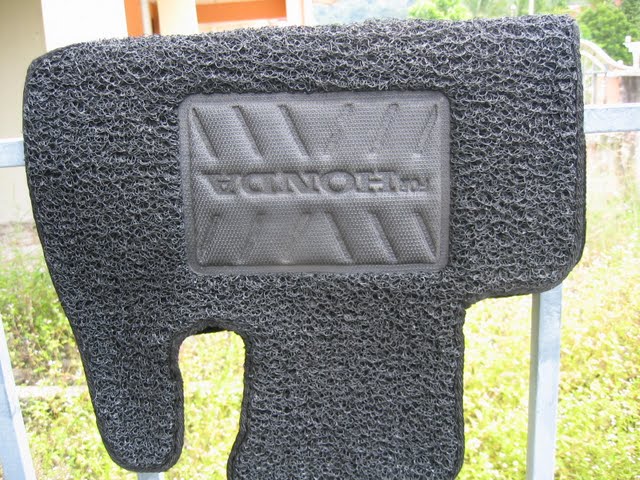

interior carpet is removed & clean by APC

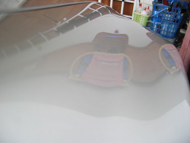

The body shop actually advise him to get his car repainted.....and the wife came home scrubing the paint as though getting rid of BBQs grill racks
severly swirled up
the amount of swirls is unbelieveble even a silver under noon day sun is
more

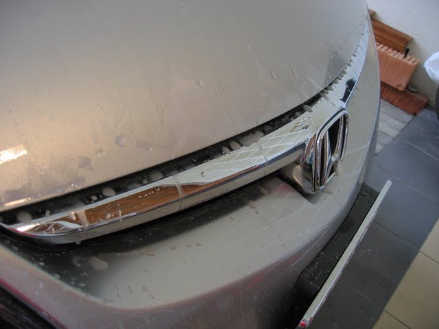

TBW & wash mitt
APC aggitating
the spots resurface

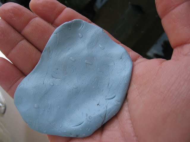

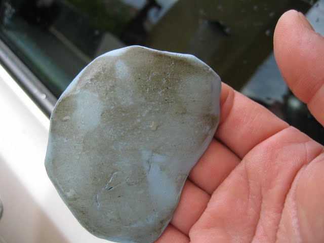

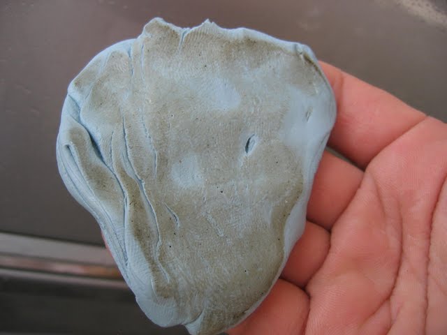

Clay before
clay after
more after clay

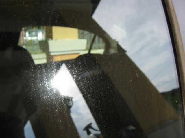

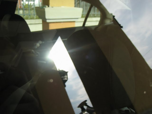

hardest to restored ......severely stained glass
tat tatatata
after

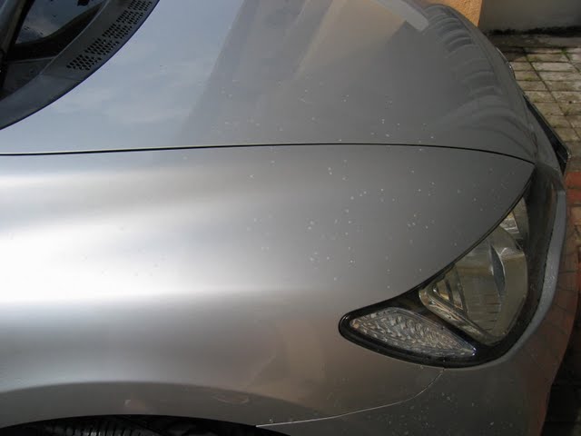

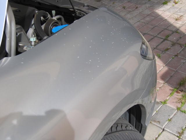

next the actual prob area
front right side panel

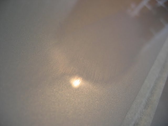

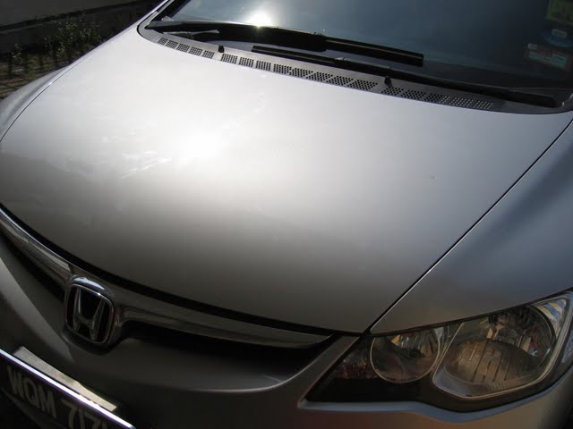

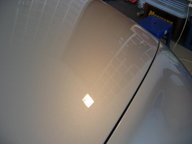

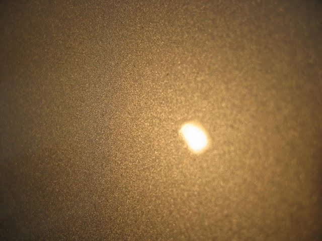

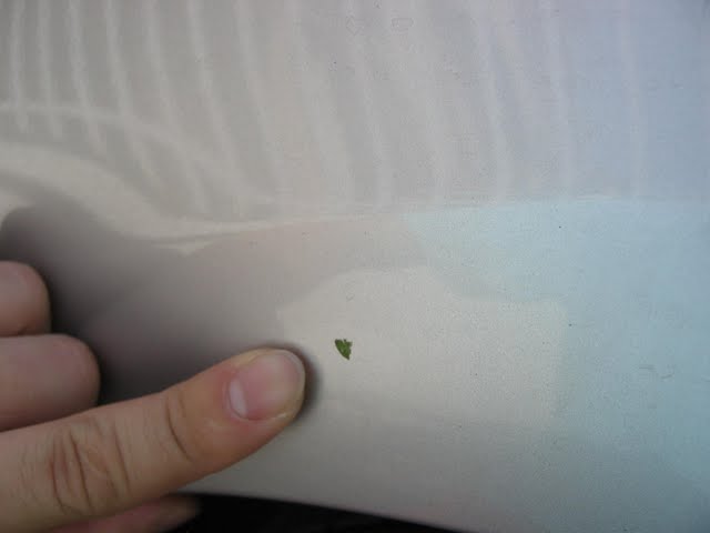

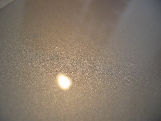

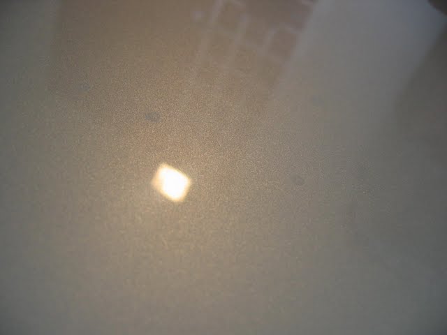

closer look at these crater
Thinking of planting the national flag - the 1st arrival on Mars

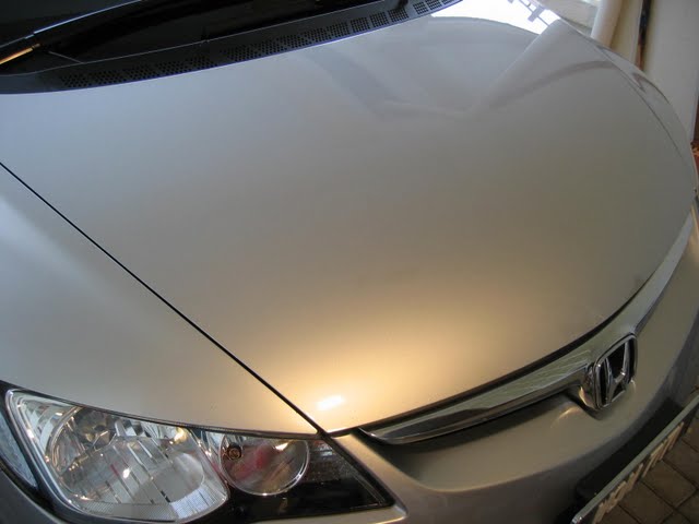

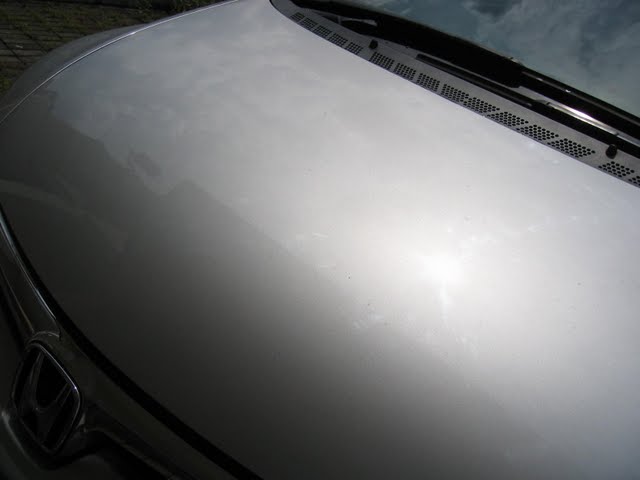

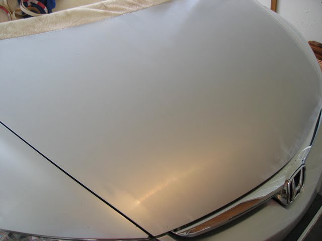

initial after 1 passes of Megs # 80
after another passes of Megs # 105 - look better

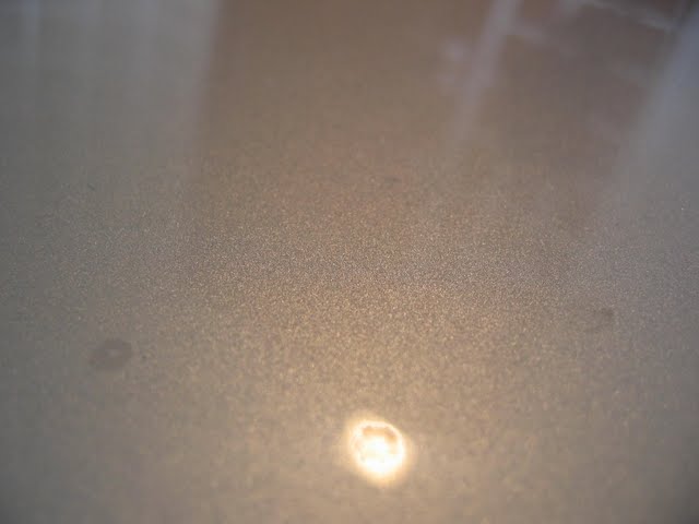

another close up of another actual crater

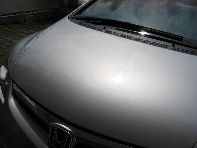

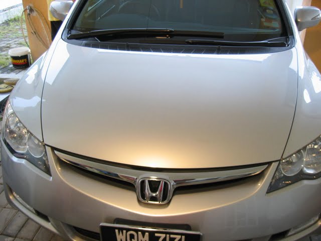

now we are at ground zero....
as the paint was corroded by these chemical & I stop & called the ownder to discuss further corrections...I suggested wetsanding, although is not the best solution on OEM paint & he gave me the blessing to go ahead
initial testing on wet sanded area
after Meguiars M #105 passes with double sided wool

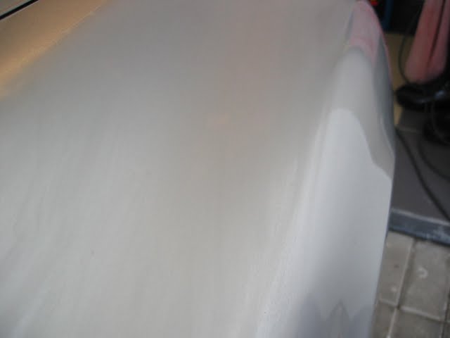

wet sanding begins
carefully sanded
after sanding
50/50 area set

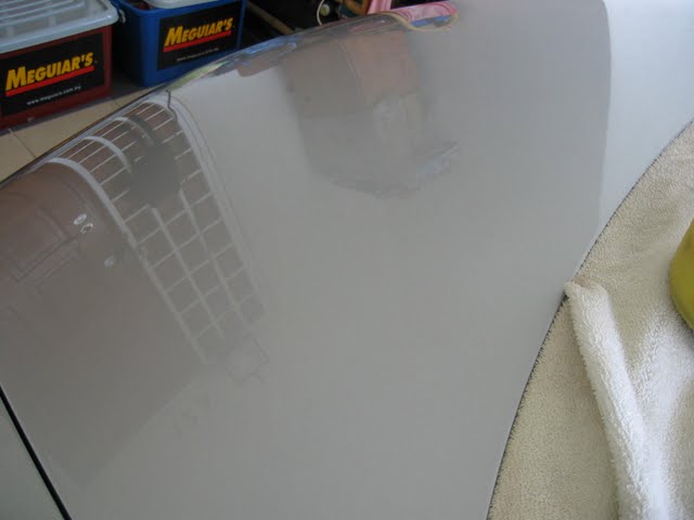

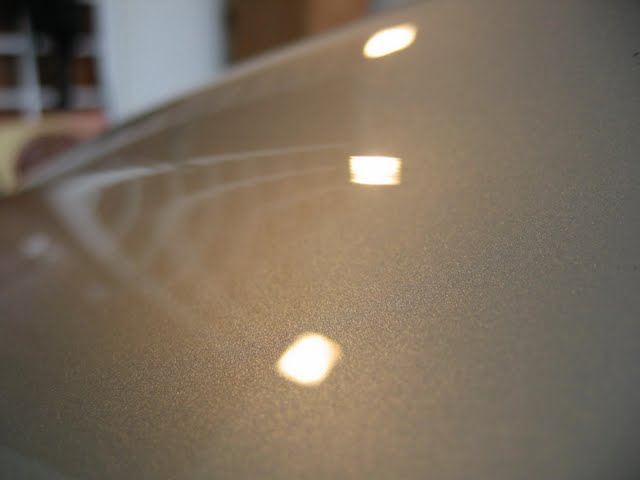

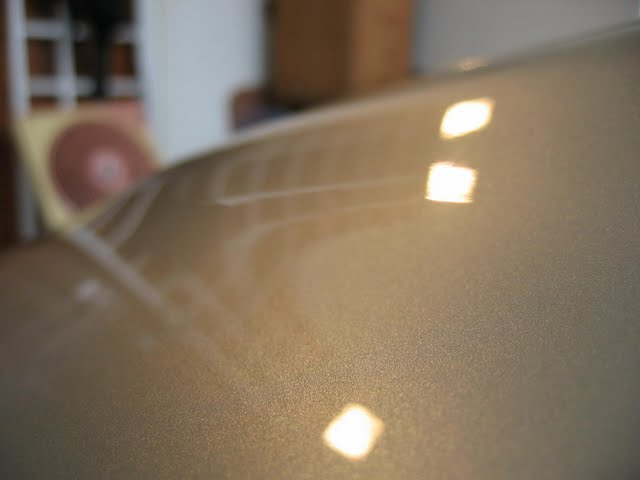

and the gloss regain & stepping down to Cutting foam pad with Megs 105
stepping down to Megs M 80

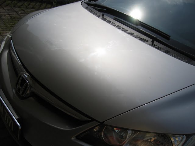

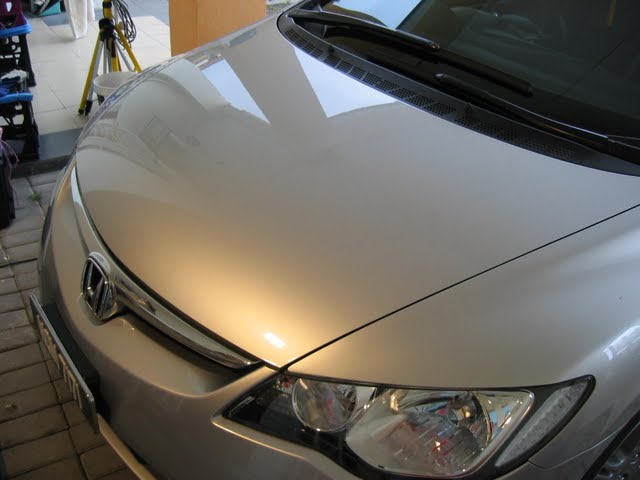

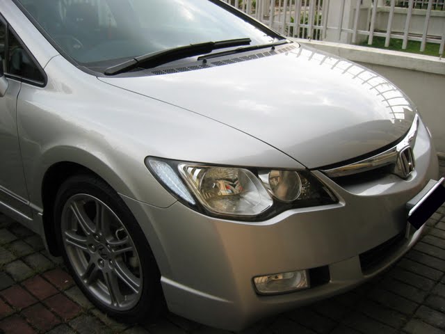

the correction leveled up
Thanks to Barry Meguairs for this wonderful invention other wise my life evry very dull

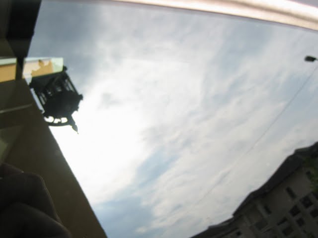

gloss restored
look at the clarity & defination restored
but some sever area is too risky to go further as may chase further in to the damage
the over looking now
some day light pics

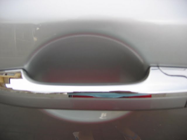

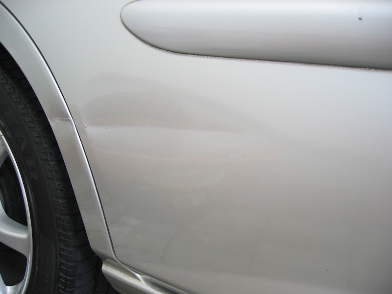

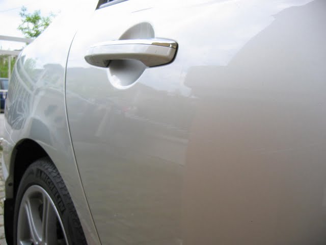

before door handle area scrathces
now
remember before
i dun why the way up always down, u need to scratchs more to get it smooth

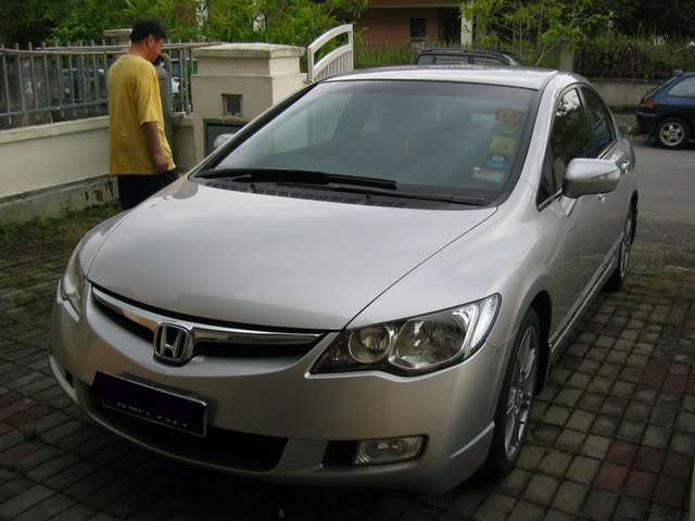

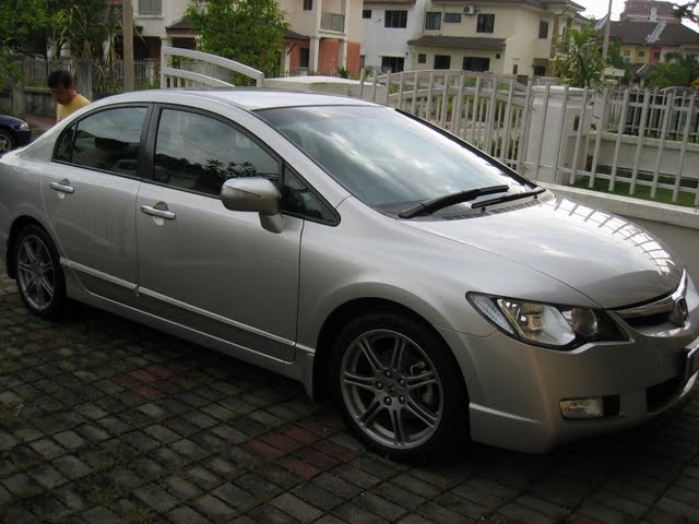

before
now

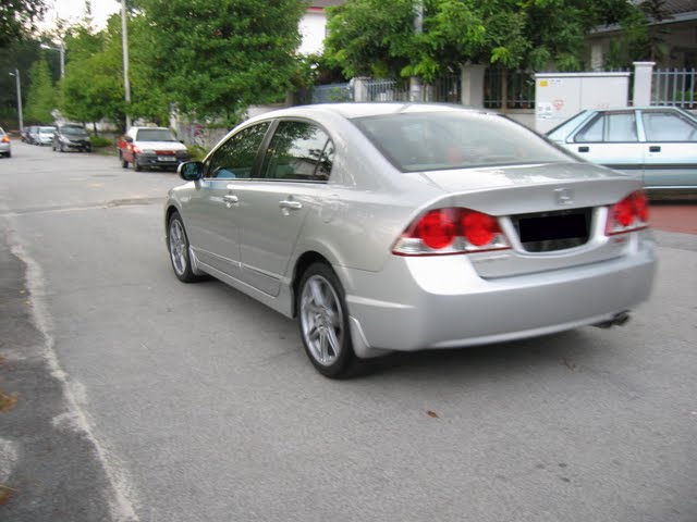

close up inspection by the owner
i actually ran after the car to shoot more after pics as he is in a hurry to drive off for his dinner
some how like seeing your own children grown up & leaving home for the very 1st time
close up pics

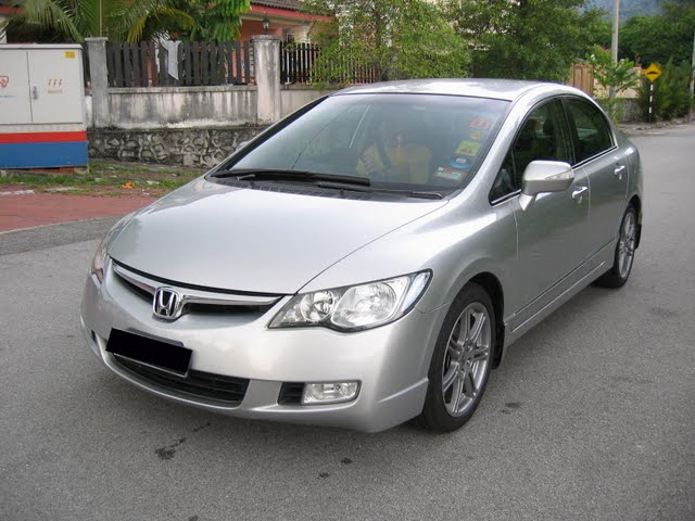

Wah kc, you really do a thorough detailing. The civic looks so new! Haha
