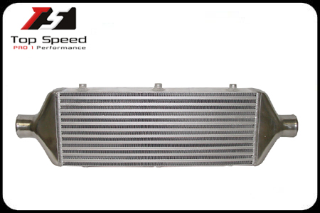

below the colourful picture is turbocharged engine, the cute black thingy is the TRD toyota racing development Supercharger...can come in many types and shapes...same goes to turbocharger snail...^_^.....the snail like figure object is what ppl know as turbo turbine ^_^....the long board with filter look alike is intercooler ^_^
