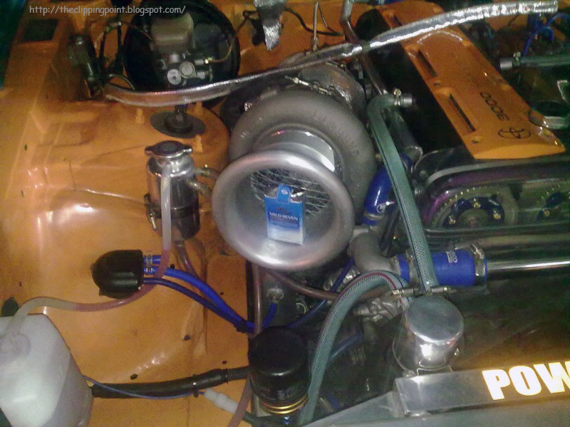

totally agree with farizio though. once saw a supra tuned in aussie. the turbine's super big.. LoL
will load up the pic for u guys.(having trouble doing it)
Bump: aiya. picture file too big(3.2mb)
any idea how to make it smaller?
