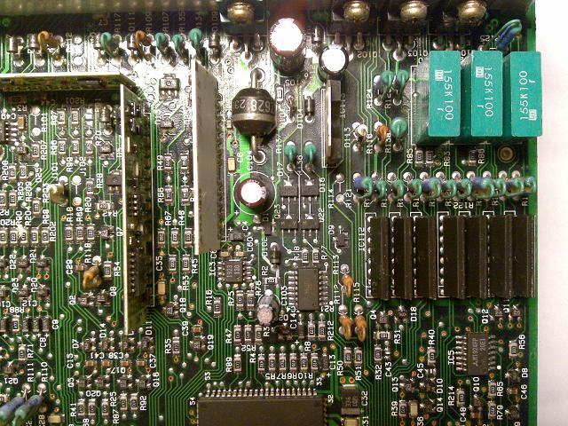

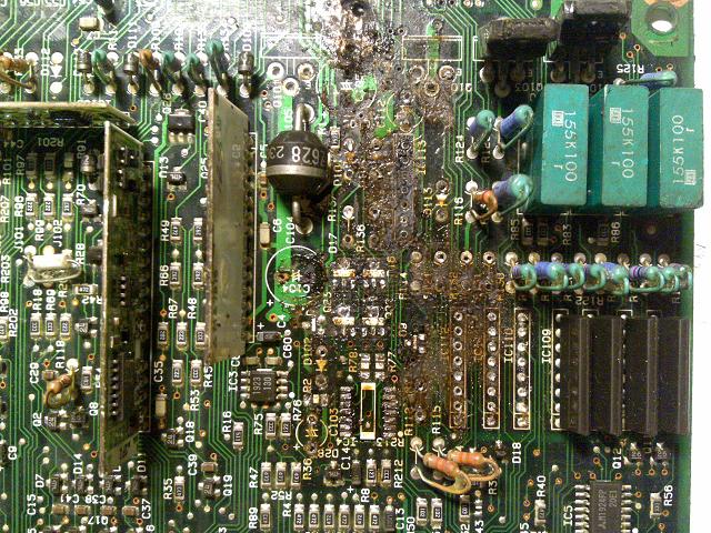

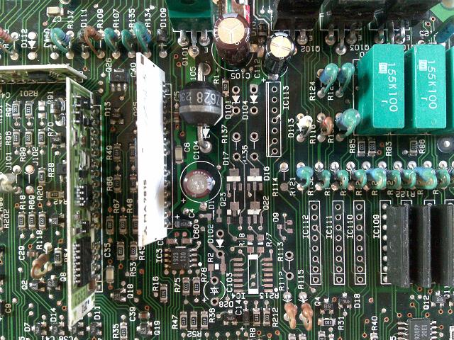

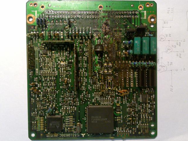

Cost to rebuilt a MD180563/64 ECU is not more than 300, that comes with one year limited warranty. This price is applying for the ECU that is not in faulty condition. If the ECU is faulty, cost to rebuilt it back will be double or even higher, depend on how severe the conditions.
Materials we use are from reputable Japanese company that has (1) higher performance and (2) longer lifespan than original materials . This is to ensure that the ECU we rebuilt is able to fully gain back its reliability and performance. We always put our customer's safety in our priority.
It is NOT recommended to let the TV technician to handle the ECU simply because they are not train to handle life threatening products. For eg, if they make mistake on the TV, they just blown the TV. But if they make mistake on the ECU, it is not only the ECU is in trouble, the driver's life will be in danger as well.
Following pic shows before and after rebuilt of a badly burnt MD180564.
