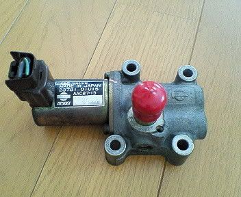

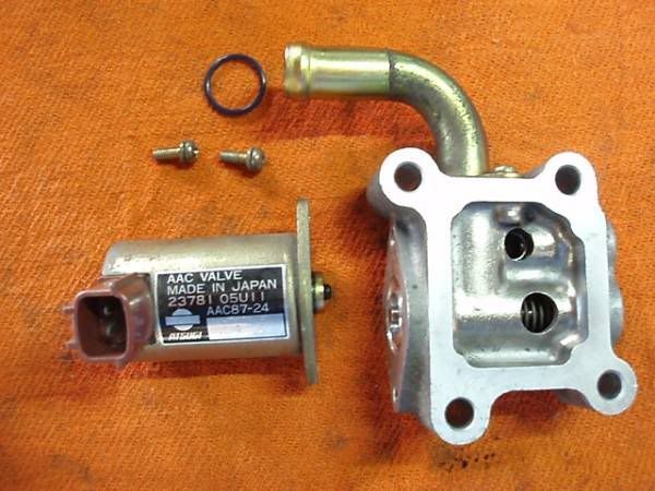

- AFM sensor
- Crank sensor
- AAC valve
Try check those.By assuming your car idling at normal speed is ok, and problm only when low rev/idling....possibility mostly is related to your AAC valve.

wow, there's so many thing to look out for, btw, wat's AAC valve? but no time to send it to workshop for "full body" check up at the moment. I was wondering could it be the alternator?

The AAC valve is the valve controlling the in/out air for idling especially when throttle off and aircond idling.Most common in GTR this thing is out wthn times.AAC valve problem would make the car die during off throttle or low rev/idling and the idling not stable.
