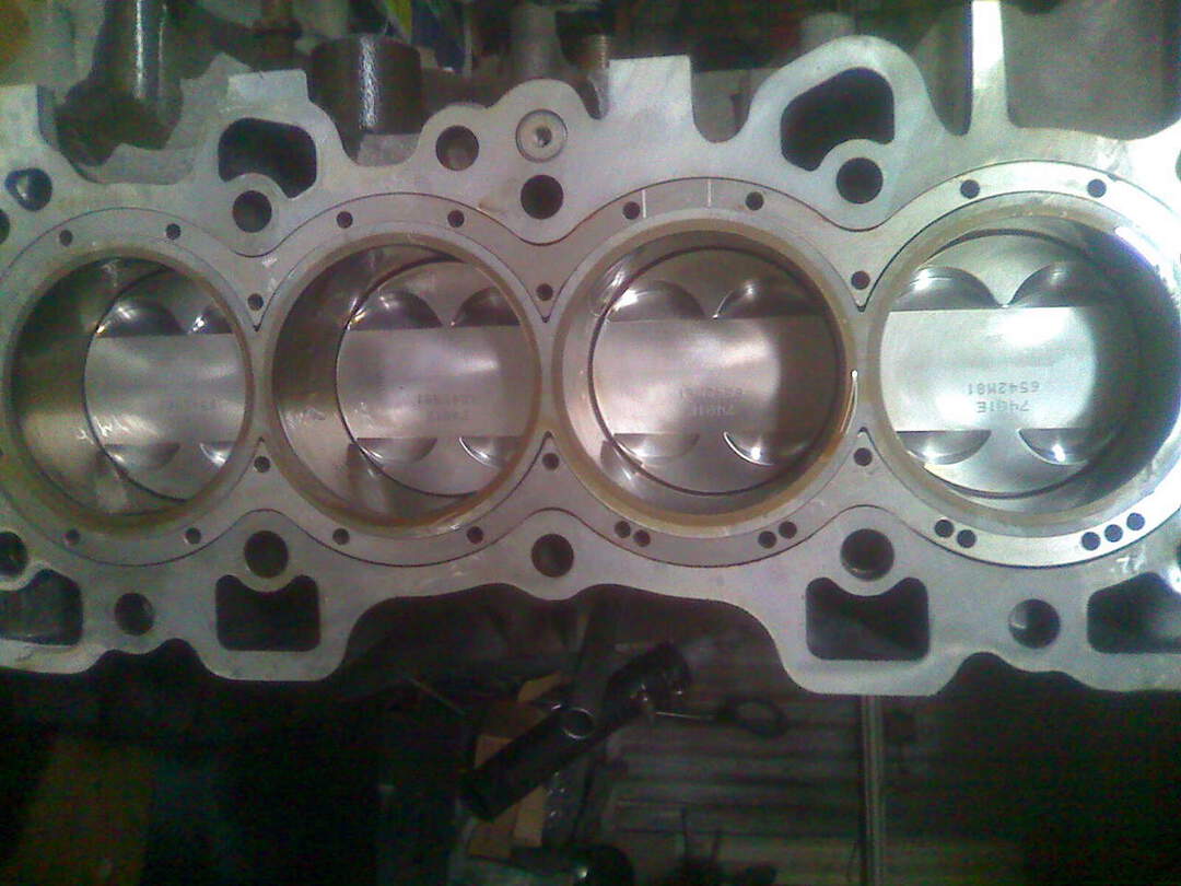

yea.. money is a constrain, here got 1 fellow, k24 still not enough in his drag car, going stroker to k27, damn...... 2 scary facts, the headgasket holes, the distance between the bores are just 1mm, and the piston size 100mm:banghead: and yet still smoke by a b20, get number 2..lol

sifu madman, can share how to built one daily driven b20 vtec? my mech told me to have the stock b20 crv conrod and piston remain, changed to better bearings, look for valve clearance, then do the oil supply lines... can it be high rev? (max 8.5k rpm) ... not target high comp machine, 10.4 - 11.0 max compression since daily driven (ron95 , ron 97 expensive nowadays:banghead:)

listen to ur mechanic...leave the b20 internals stock... but the bearings i think use stock bearings oso ok....use better bearings of course better la...but i dont see a need.
u definitely need some form of management...e-manage with ignition harness minimum is my suggestion so u can tune proper....mine witth VAFC only damn hampeh...no ignition tuning bikin leceh...crome oso ok if u can find one and a tuner....get the management then u can tune for ron95....do not chip! coz u dont know wats the mapping in the chip...better to have something mapped for ur specific engine
as for high rev...keep it max at 8k. coz the b20 crank isnt really made to take that much revs... even my balanced b20 engine oso i go max 8k only (sometimes got la accidentally 8.5k hehehe)

all sifu, who know what extractor can be used for b20 vtec setup? i heard b16 extractor cant use since too short , kena oil sump.. how bout the b18c? i do ask also some say can some say still kena oil sump:banghead: plan to get hotbit extractor so accurate info needed.. tq all sifu

b18c block height with B20 block heigt should be the same...but the oil sump design not sure same or not... mine i using custom 4-1.

Actually b20 block shorter by about 0.55mm from b18c block. It should be no problem at all.
For the oil sump, b16a and b20b oil sump basically the same.
Currently running homemade b20vtec few time reach 9.2k rpm and mostly 8.8k rpm
