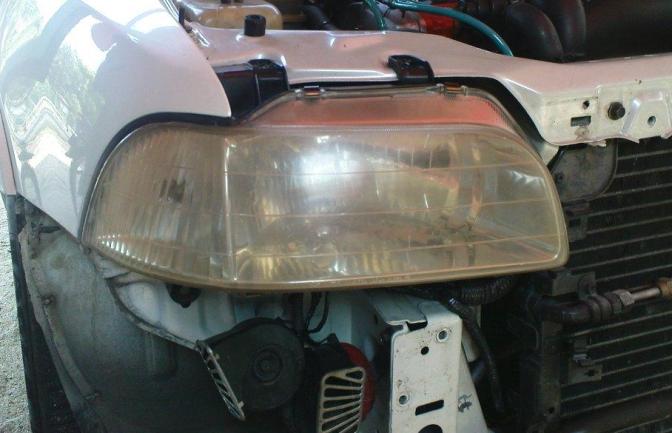

if i sand the headlights the headlights will have scratches right? won't it do more damage to the headlights? what kind of polishing compound should I use?

i think the polishing compound used in this diy is Rubbing Compound.
its like polish cream, but got "microsand" substance. can be feel if u try with ur finger.
its like finest grade sandpaper, but in cream form.
hardware got. just ask for rubbing compound.
it will remove 2500 grade "marks".
if want to make sure, try the steps on other surface 1st.
preferable clear plastic.
the u will get the idea how to polish ur headlamp.. i mean ur car headlamp

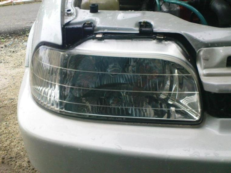

The purpose of sanding headlights is to even out the layer (remove scratches) for a mirror, crystal clear finished after compound and polish. :itsme:
we are using Optimum compound in this video clip !
Optimum Compound detail : http://www.ultimateshine.com.my/webshaper/store/viewProd.asp?pkProductItem=23
After compounding, the result is shine like wax, we suggest another layer of sealant to protect from UV ray damages. :biggrin:
