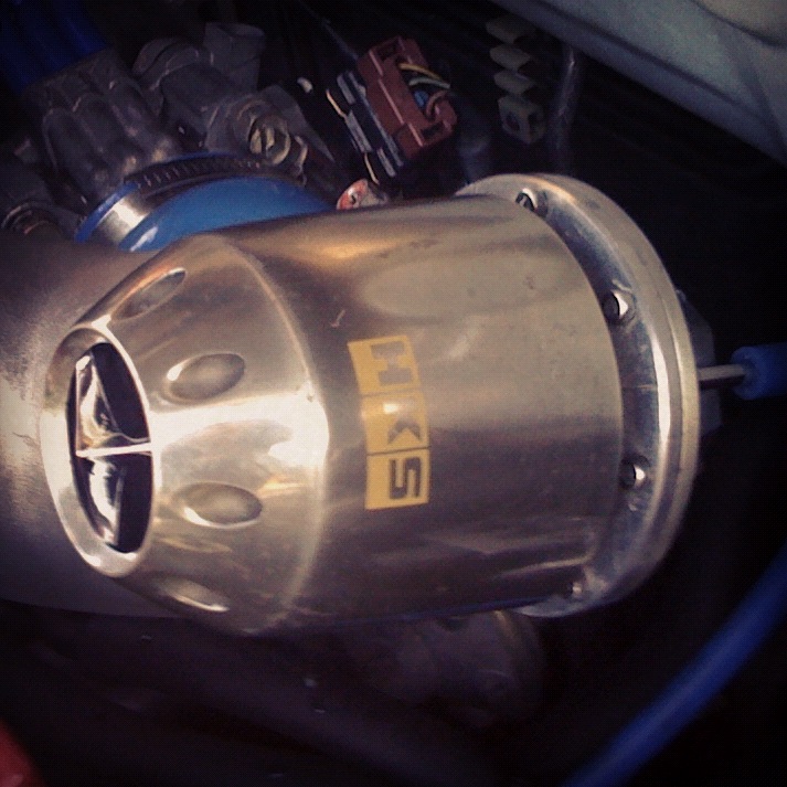

I am not sure which model of SSQV I am using. I am guessing either 2 or 3? Here is a picture. It comes together with the original HKS intercooler piping.

that is Type-I 2nd edition where the logo is just the emblem.. This one also got two models, one with adjustable spring rate screw and the updated one without..
Type-I 1st edition has the Super SQV lettering instead of the HKS emblem.. Type-II onwards has the fins on the sides..
