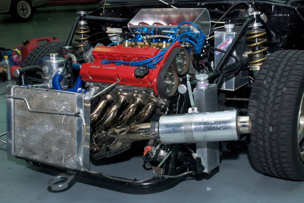

45degree engine...like motorbike pulak...cun laa this engine
Hooo "ini enjin manyakk jahat woo,,,gua tak suka ooo" translate to hooo this engine got crazy horses oooo hehe.

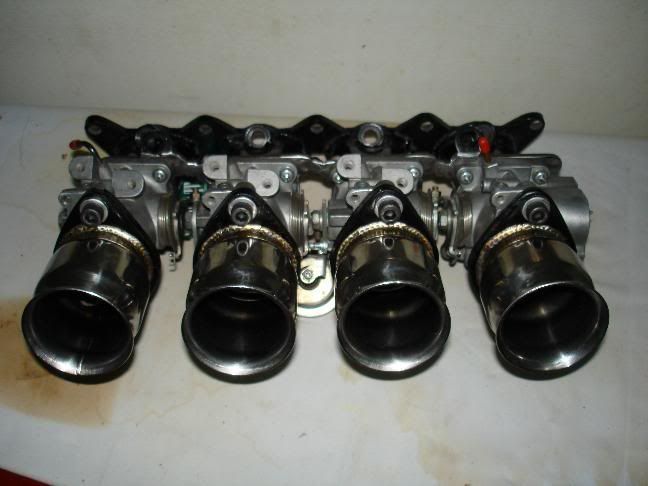

If you read this thread from the beginning you'll find a rough cost estimation of this project. As of how much HP and Torque gain, you can ask those dynoed fellas. I havent dynoed my car yet. Will be getting in very soon.
My estimation of hp gain is around 10-20ish. not much for a stock engine/cam/bottom end. The real answer lies when I go for a dyno. But then again I never dyno the car before modding.
my setup is totally for street. although no a/c. but still streetable. Been using it for over a year now and it feels nice. although there a slight let down in my mileage.
i dunno how to compare mine with those racers/drag machines with 4throttle. they'r totally different, although the basic principle is the same.
i totally did this with my own idea from just observing, researching and ofcourse help from a tuner. but the important thing is, if u want it to be a street car. u must build it. or at least take part in it. its not a normal car anymore though u can drive it on the streets.
for me, i learnt a lot building it. and improving it. i tell u im not a tuner/mechanic/tracky/racer at all. but i love driving fast. i believe i am a true car enthusiast. i like to research things before thinking of making it a project and know the pros and cons months before even making the right decision.

If u were to go ITB make sure that all the mechanical parts r used correctly, also use a full standalone management, if u got management idling n running v AC will not be a big issue...I myself is running on ITB on a 4G93 for 1 and half years, and also mine is a daily driven car....Remember used correct parts,go to a right mechanic n tuner!All da best in building ur ITB....cheers
