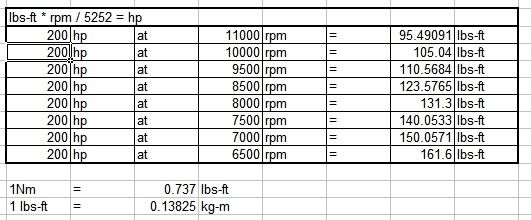

Okay.. here's some of the things I've learnt during my course of modding my car.. hopefully this will be a place to put together various forms of calculations in one place for reference to any new or current members of Honda ZTH forum. Some of this calculations will be applicable to other makes as well so hopefully this will be a definitive resource for all car models. Of course, I'm a human, so I tend to make mistakes, so hopefully forummers can help correct any mistakes that I make. It's also a chance to check for mistakes in anything I have learnt.
Forummers can also contribute any information they know.
Here's to more knowledgable, savvy, car modders in Malaysia. Cheers!
